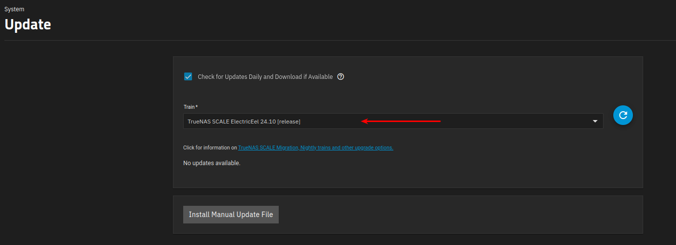

Is upgrading as easy as switchng train here :
And then follow whatever it tells me to do ?

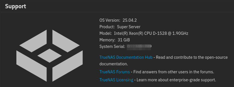

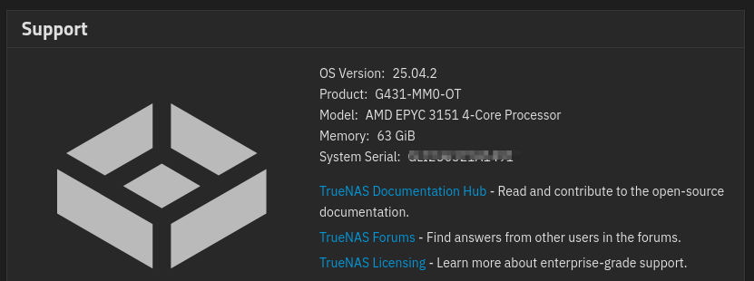

I have currently upgraded both of my systems to 25.04.2 and everything for me went fine. It took about 6 minutes to update one system from 24.10.3 and about 10 minutes total.
