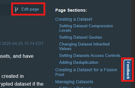

For anyone reading the thread who is not already aware of it (as I’m pretty sure @Stux and @dan are) you can always file a documentation issue with the Feedback button to report a docs issue or even use the Edit Page button to propose a correction yourself. We’re always happy to see community contributions :hugs:
