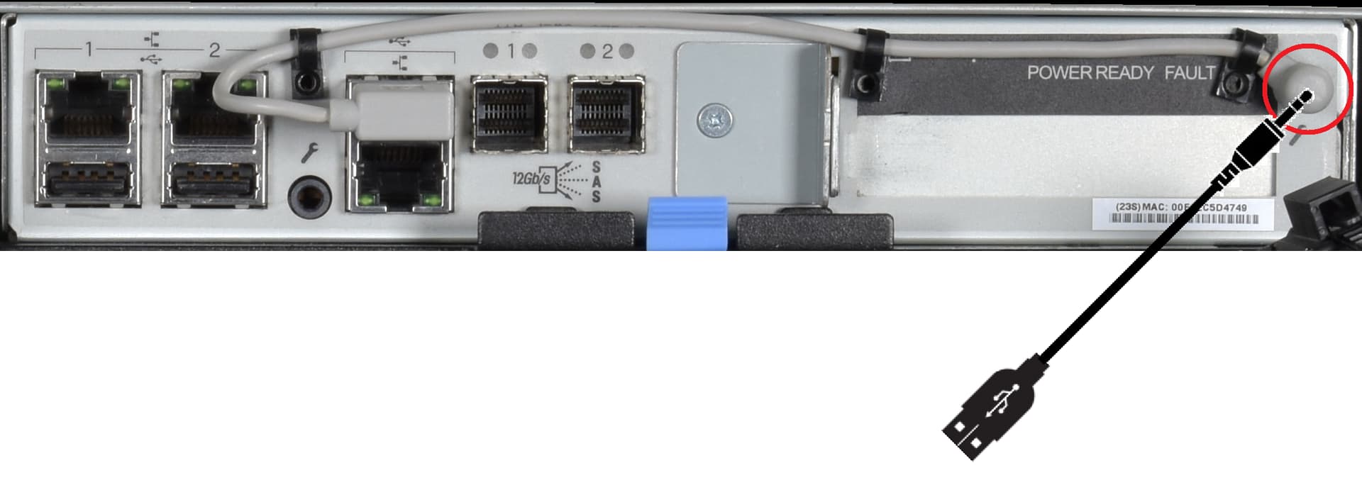

We have a X10 at work that support is EOL for. I want to migrate it to Scale from Core/Enterprise. It’s a single head unit, so no fancy HA to complicate things. I’m trying to get either a serial console, or into the IPMI. We’ve had this since new, but we never setup the IPMI. I can connect to it on 192.168.100.100, but only on SSH and I don’t know the credentials to log in. Is there a way to do a factory reset on the IPMI from the motherboard? Alternatively, I could serial into the system and do the install that way, but I can’t seem to get a console connected. Is the standard console on the left or the right? I’ve connected to the port on the right successfully, but it seems like a dedicated low level hardware management connection, not the regular console.

Hello @gedavids
Happy to help with your OOS system here.
For basic serial console access so that you may install SCALE this is the appropriate port to plug the cable into.
You should use the serial settings 115200 baud, 8 data bits, 1 stop bit, no parity, no flow control
  • Switch to the system console mode by entering: $%^0
  • Press Enter twice after typing the characters. The normal system console is displayed. When you reboot, you can watch it POST and go into the BIOS to modify the boot order to allow you to boot from a SCALE ISO and install normally.
