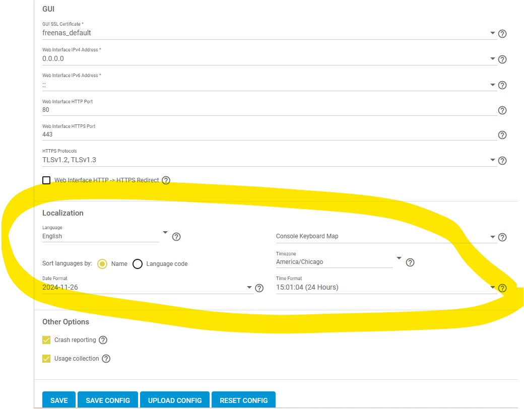

Well, interestingly it looks right in the general tab.

That doesn’t show you the actual time and date, it just shows your the format it will display the time and date using.
The wget command showed you that the server actually thinks it’s 2013. You need to correct the BIOS time or else all secure connections will fail, since they are dependant on the client and server agreeing on what the date/time is.
