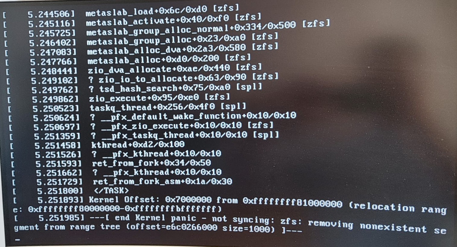

Can you tell if the panic happens when trying to import the data pool?
Is it possible to take a photo of the screen when it panics?

This might sound silly, but is there more above or below the portion you captured?

I’ll try and take a few more photos as that is the top of the screen

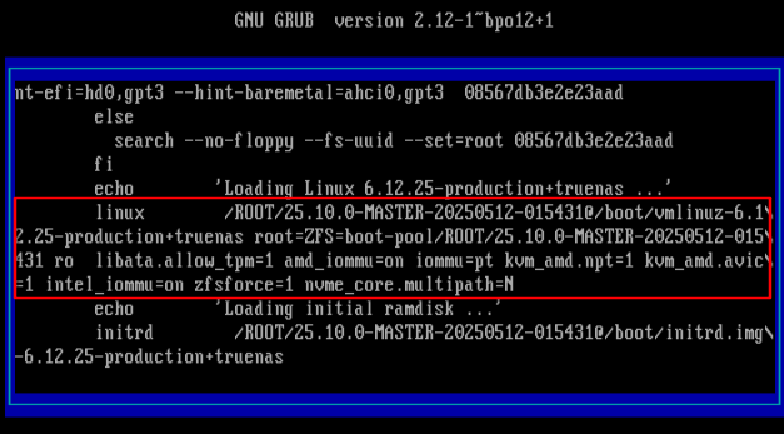

On the boot page, press “e” on your primary boot option:
Then arrow down until you see this “linux” line:
Add zfs.zfs_recover=1 to the end of the line then press ctrl+x to boot. With the data disks disconnected, that should hopefully get you into the system and able to download a config backup. I’d recommend a reinstall after the fact, technically you could leave it for a bit as I mentioned earlier, but considering how easy it is to reinstall once you have a configuration backup better safe than sorry!

Unfortunately that resulted in a kernel panic at the same point.
