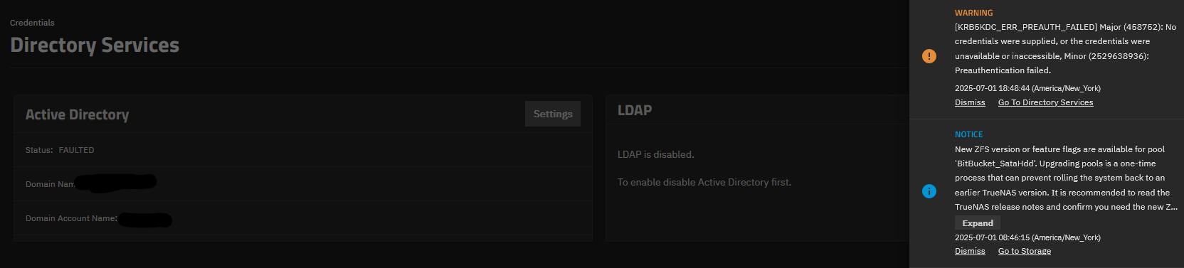

Hello- Trying to troubleshoot an error I keep getting on one of my 2 truenas arrays which are joined to my domain. The error I get is:
[KRB5KDC_ERR_PREAUTH_FAILED] Major (458752): No credentials were supplied, or the credentials were unavailable or inaccessible, Minor (2529638936): Preauthentication failed.
Both arrays are added to the same domain using the same credentials. I am not sure why it keeps happening. I have to essentially turn off AD, enter in the password for the AD user again and turn it back on. When the error occurs I am unable to see any of my groups or users from AD in the TrueNAS GUI, but shares are still working and it appears to still respect the permissions based on AD that are already in place. Thanks!

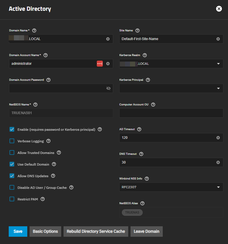

Can you share a screenshot of your AD config in TN.
I presume your NTP servers are the same on TN as they are in AD?
Here is my AD config. My NTP servers on TN are pointing at my domain controllers:

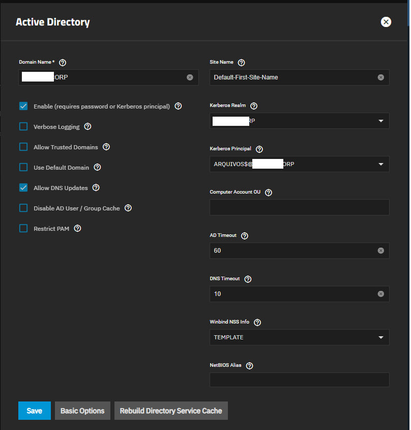

I also have the same issue, had with version 24.10 and now same thing with 25.04.
It happens from time to time, can only recover by removing the server from AD and then adding again, but dos not always work at the first time (or did not found a consistent way to do it). When this happens the access to the storage is lost by the AD users.

Just want to add i’ve been getting this as well. This morning I had no access to my windows redirected folders (any normal file access). Looked at active directory status on both truans, and both are “FAULTED”. SMB service was also turned off and did not auto-turn back on.
had to uncheck enable require password or kerberos principal, save, then go to advanced settings and remove AD_MACHINE_ACCOUNT under Kerberos Keytab.
But the issue always comes back.
