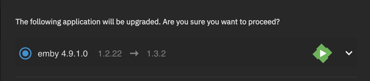

Latest update of emby today fails
I assume it’s the same problem like the other failed updates. Just a different error message

The app is going from v1.2.22 to v1.3.0, and I am running TrueNAS 25.04.1

    dict_obj = await self.middleware.call(
  File "/usr/lib/python3/dist-packages/middlewared/main.py", line 1000, in call
    return await self._call(
  File "/usr/lib/python3/dist-packages/middlewared/main.py", line 715, in _call
  File "/usr/lib/python3/dist-packages/middlewared/plugins/apps/schema_validation.py", line 37, in validate_values
    verrors.check()
  File "/usr/lib/python3/dist-packages/middlewared/service_exception.py", line 72, in check
    raise self
middlewared.service_exception.ValidationErrors: [EINVAL] values.network.web_port: Field was not expected
I managed to find a temporary solution…
  1. Turn off the current emby instance.
  2. Install a new emby instance with different name. (last version)
  • Make sure all settings between the apps are the same… (Ports, data paths and resources)
  • Also make sure to create new data set with different name for the new emby and don’t forget to give the same permissions.
  • Don’t forget to specify the new data set under the setting “Emby Configuration Storage” in the new emby instance.
  1. Launch the new emby with the last version and than stop it.
  2. Located the data folder of the old emby and remmber it.
  3. Get into the Shell option inside the truenas and type ‘mc’ > navigate using the file browser to the old emby folder > right click on all the folders there > press F5 to copy the selected folders > it will as to where, than delete the /root/ and enter the new emby location:
/mnt/pool_name/location_of_the_new_emby_folder
  1. After all the contend copy > run the new Emby app!
Good luck!
