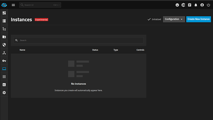

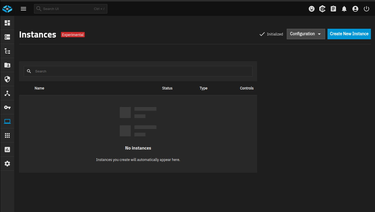

So I blew away all my instances and redid them, now I can get into stable and reboot, but I still get this error based on my cloud-init config I posted earlier. I also reinitialized the pool and it’s still default. So that didn’t affect anything since the pool didn’t change on my install. Just posting the error again in case it changed, doesn’t look like it. Instances don’t show up though. I’m kind of at a loss right now, as this worked in RC.1.
pydantic_core._pydantic_core.ValidationError: 4 validation errors for VirtInstanceQueryResult
result.list[VirtInstanceQueryResultItem].2.userns_idmap.uid
Input should be a valid dictionary or instance of IdmapUserNsEntry [type=model_type, input_value=None, input_type=NoneType]
For further information visit https://errors.pydantic.dev/2.9/v/model_type
result.list[VirtInstanceQueryResultItem].2.userns_idmap.gid
result.VirtInstanceQueryResultItem
Input should be a valid dictionary or instance of VirtInstanceQueryResultItem [type=model_type, input_value=[{'id': 'apps1', 'name': ..., 'memory': 4294967296}], input_type=list]
result.int
