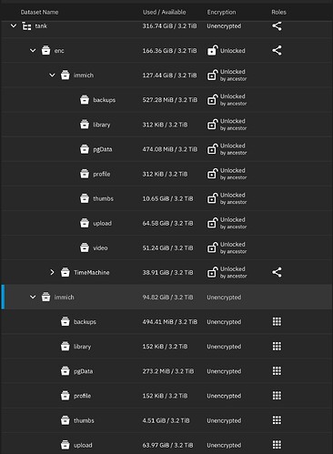

First to show the dataset structure:
I made one snapshot of the unencrypted immich parent dataset with all it’s children. When the snapshot was made the files were all intact. Other then that, no backups or any other form of data protection were made.
After that I made the encrypted dataset “tank/enc/immich” and started a zfs replication task from “tank/immich” to “tank/enc/immich”. No errors or failures and all went smooth.

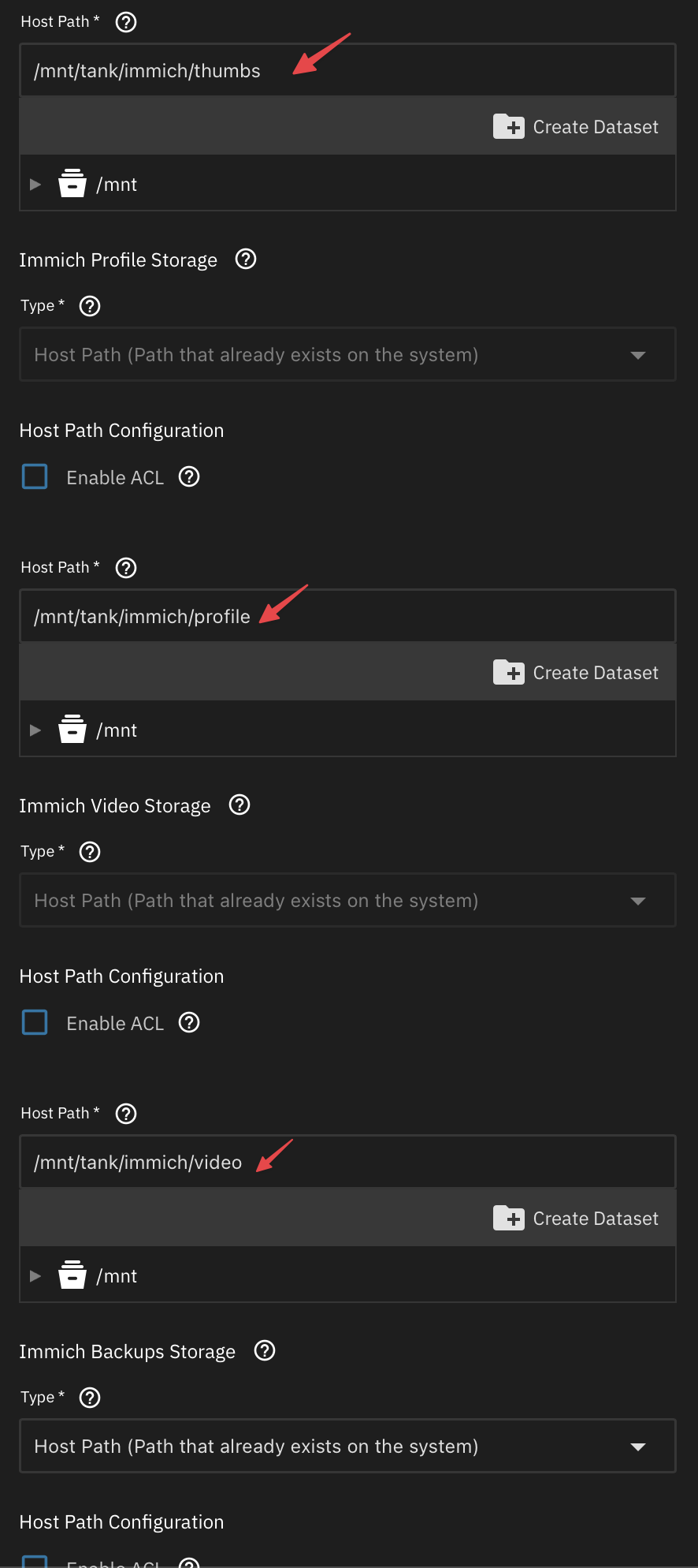

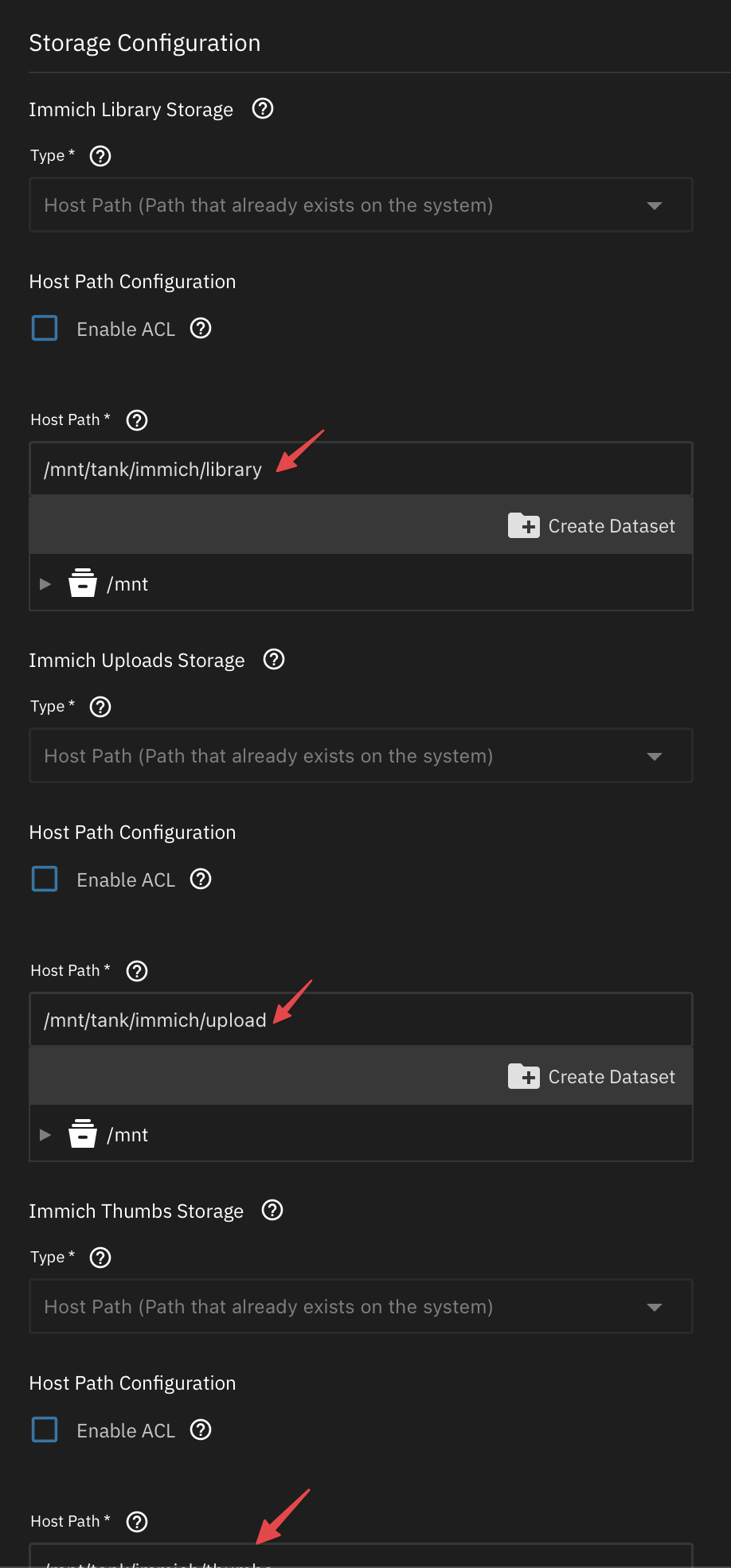

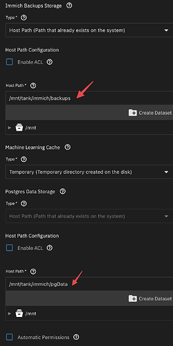

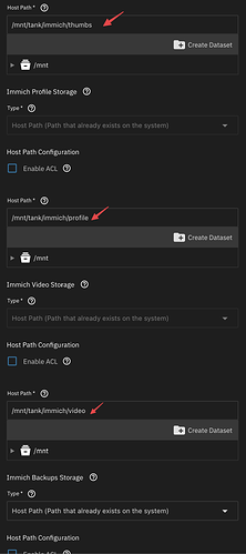

Then I went to the immich app on truenas, edit configuration info and changed the host paths from “tank/immich” to “tank/enc/immich” for every dataset:
Now I opened the immich mobile app and all photo’s are working fine, but when I open a video it’s jitters A LOT and green artifacts.
After that, I changed back the host paths to “tank/immich” and restarted the server, but the videos are still corrupted.
