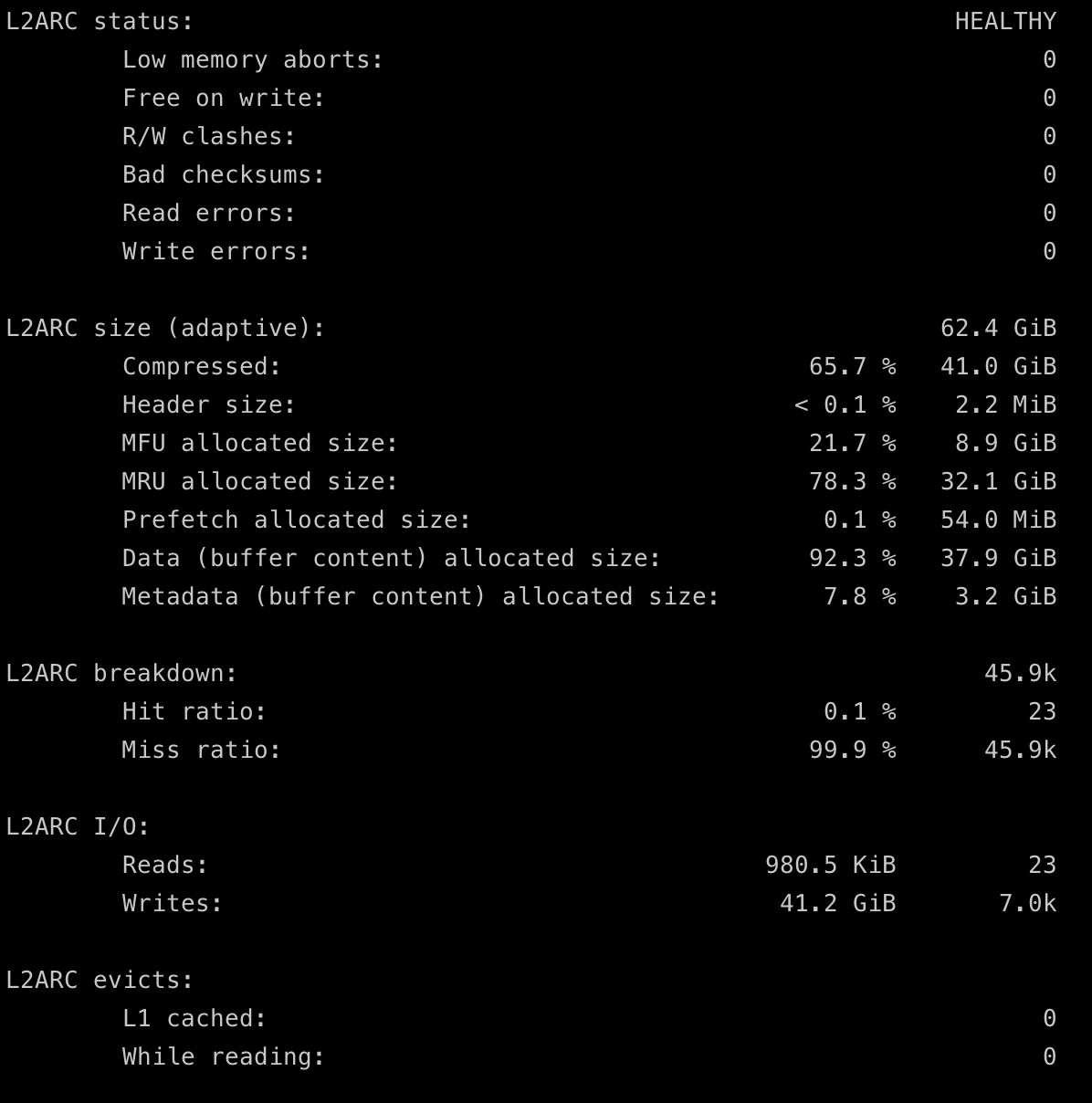

I am fairly sure that isn’t correct, since I don’t think all of my pools metadata has been shoved into L2arc yet. I could be missunderstanding this, though. This is my arc_summary output pertaining to L2:

If metadata is in the ARC, why do you want to shove it to the L2ARC?
I want it to persist reboots, and I want my entire metadata in L2. My RAM capacity is at the max I can provide it (50GB), and that isn’t enough to hold all metadata even if I could force ARC to be 100% metadata only (which I can’t, and wouldn’t).
The intent with this was to not do a special vdev for metadata but shove it all into a L2arc solution to gain snappy response of the system. Since I don’t access files often, they will not get into arc nor L2arc until the one time I am looking for that data. My goal is to make the system feel like it’s flash based from a navigating directory perspective.

I would have to defer to you, since I can’t speak on it. I never used an L2ARC or experimented with such settings. The only parameter I noticed benefit from was arc_meta_balance which I changed from the default of 500 to 2000, to favor metadata over data in RAM. This only affects the ARC, so I’m not sure how it would work with an L2ARC for metadata.
The inverse might work better for your setup. The L2ARC can be left to its default (secondarycache=all), with a high priority of metadata in the ARC. Then the metadata will stay in RAM, and any data that would otherwise pressure metadata eviction from the ARC will instead be evicted… to the L2ARC. This way, you get the best of both worlds and lower the reliance on spinning HDDs.
In ZFS, I’m not sure if the L2ARC will hold duplicated metadata that already exists in the ARC? I don’t believe it was designed like that. This means that rebooting with a persistent L2ARC would ironically favor evicted data?
