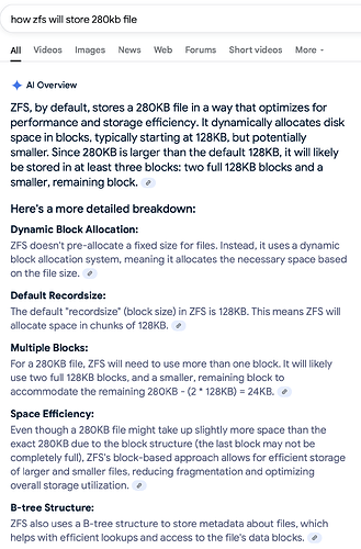

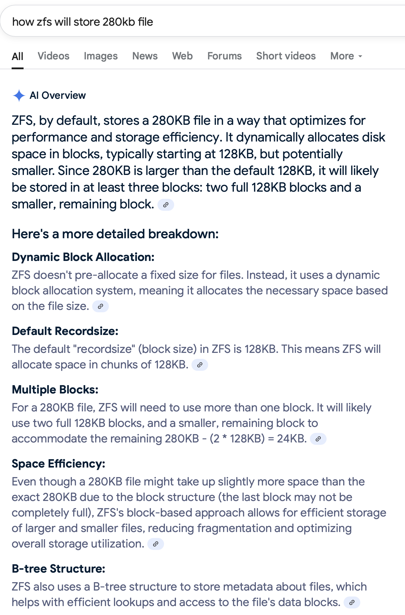

For files of 2-8M? That sounds like it’s asking for an awful lot of wasted space.
Aiui, the actual blocksize is not a constant (in ZFS) dataset-wise. So the recordsize is just a maximum possible value for the dataset.
I'm just too lazy to find a reputable source, so...
@winnielinnie explained it to me, which is why I adopted larger recordsizes for my NAS once I also implemented the sVDEV. It was space efficient and dramatically reduced metadata as well.
See the sVDEV resource for the details.
It was never really clearly communicated to the end-users, and there’s a confusion between “recordsize” (a dataset property), “block”, and what I like to call “block-on-disk”, which also applies to the ARC.
