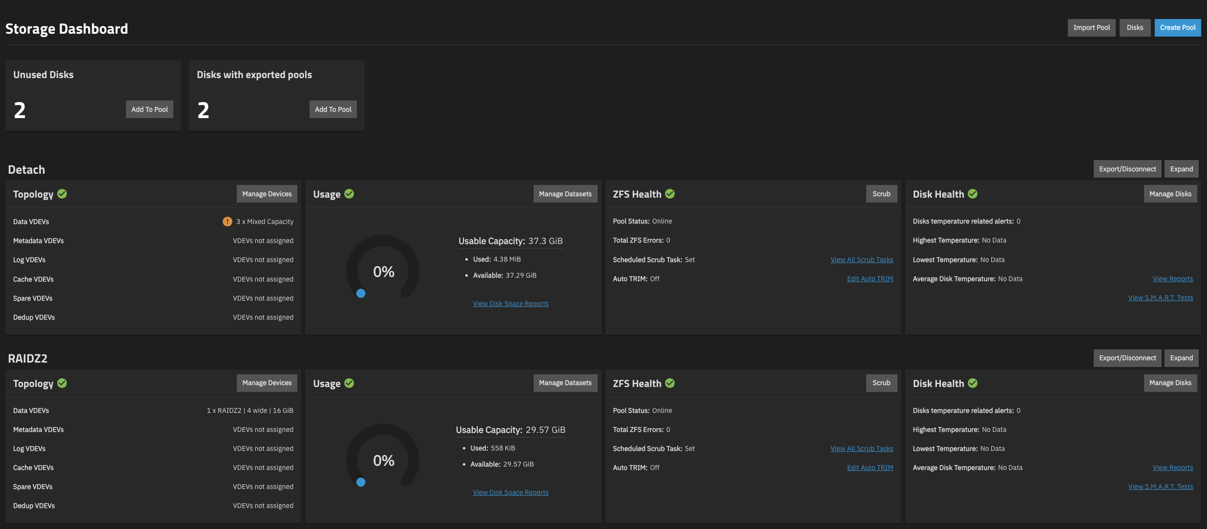

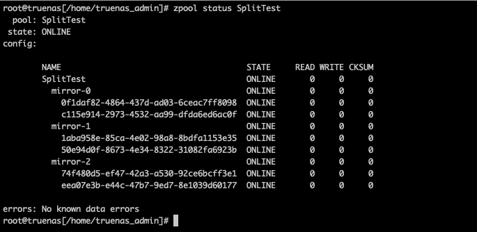

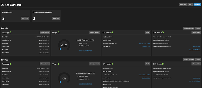

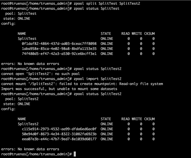

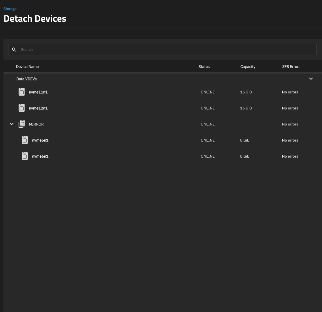

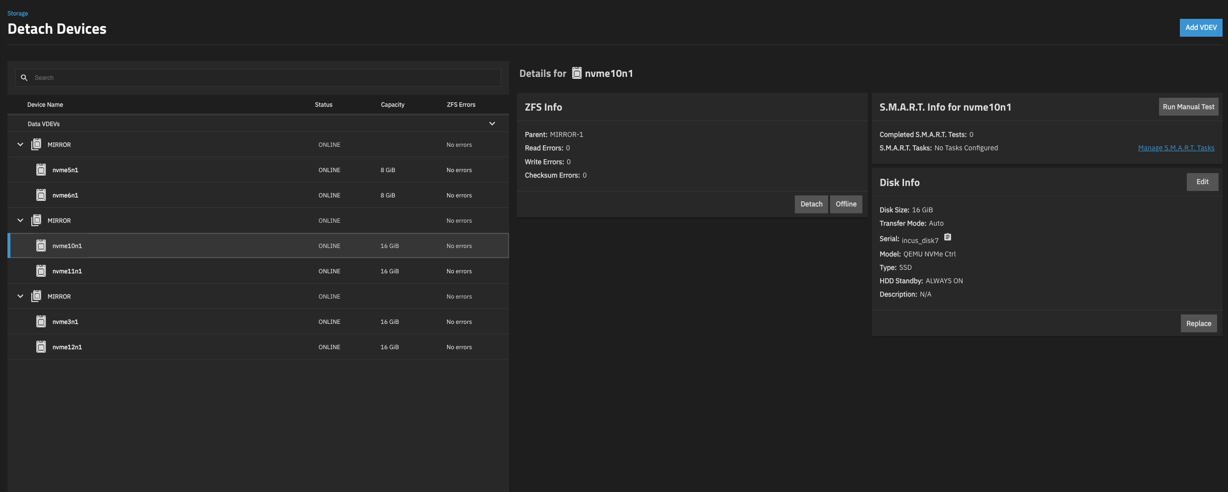

I don’t believe TrueNAS currently supports zpool split but it essentially takes a mirror (or multiple mirror vdevs) and splits them into two discrete pools each becoming a stripe (both retaining all of the original data). What you decide to do after that is your choice.
Here is an example of what your setup would look like from the CLI.

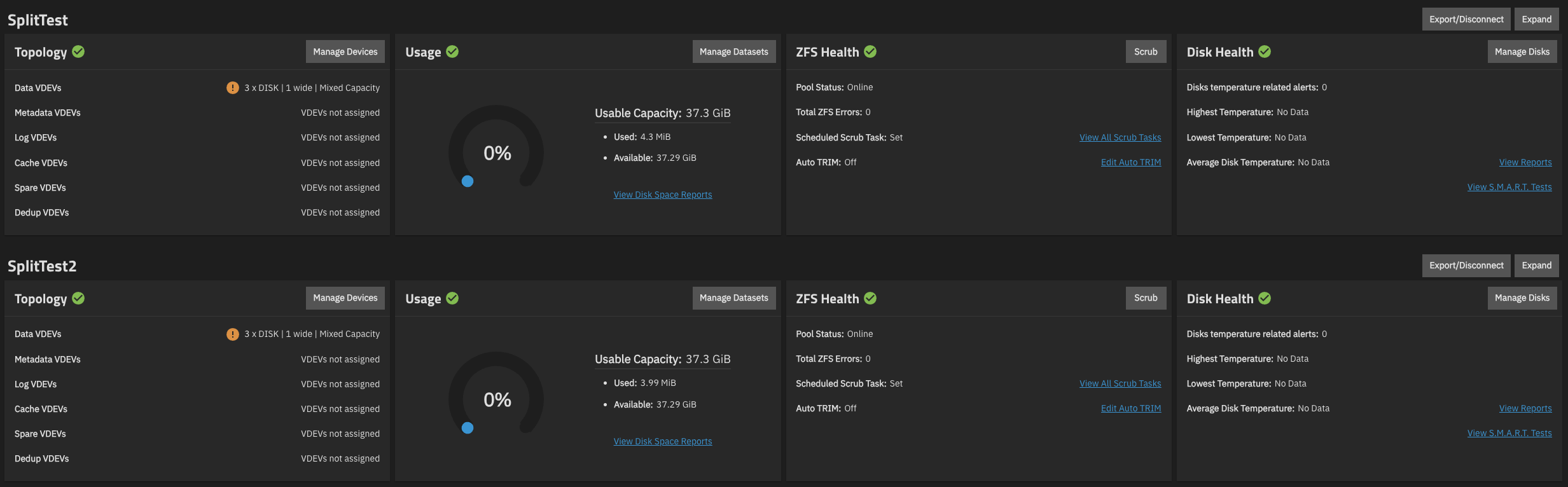

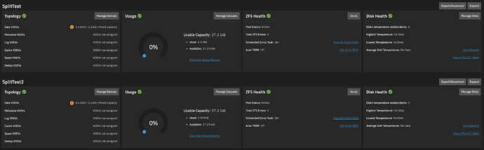

Once exported from the CLI and imported via the UI they look like this.
I used GiB volumes instead of TiB for obvious reasons.
You could now potentially destroy one of the pools and that would give you the following drives to play with.
