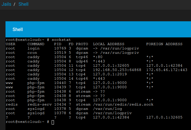

When you enter the jail and type
sockstat
Can you see caddy running?
Definitely seems like it…

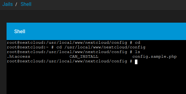

Its at /usr/local/www/nextcloud/config/config.php
…huh…I used to have one because I had edited it to the new domain. It’s not there anymore after a new scripted install…

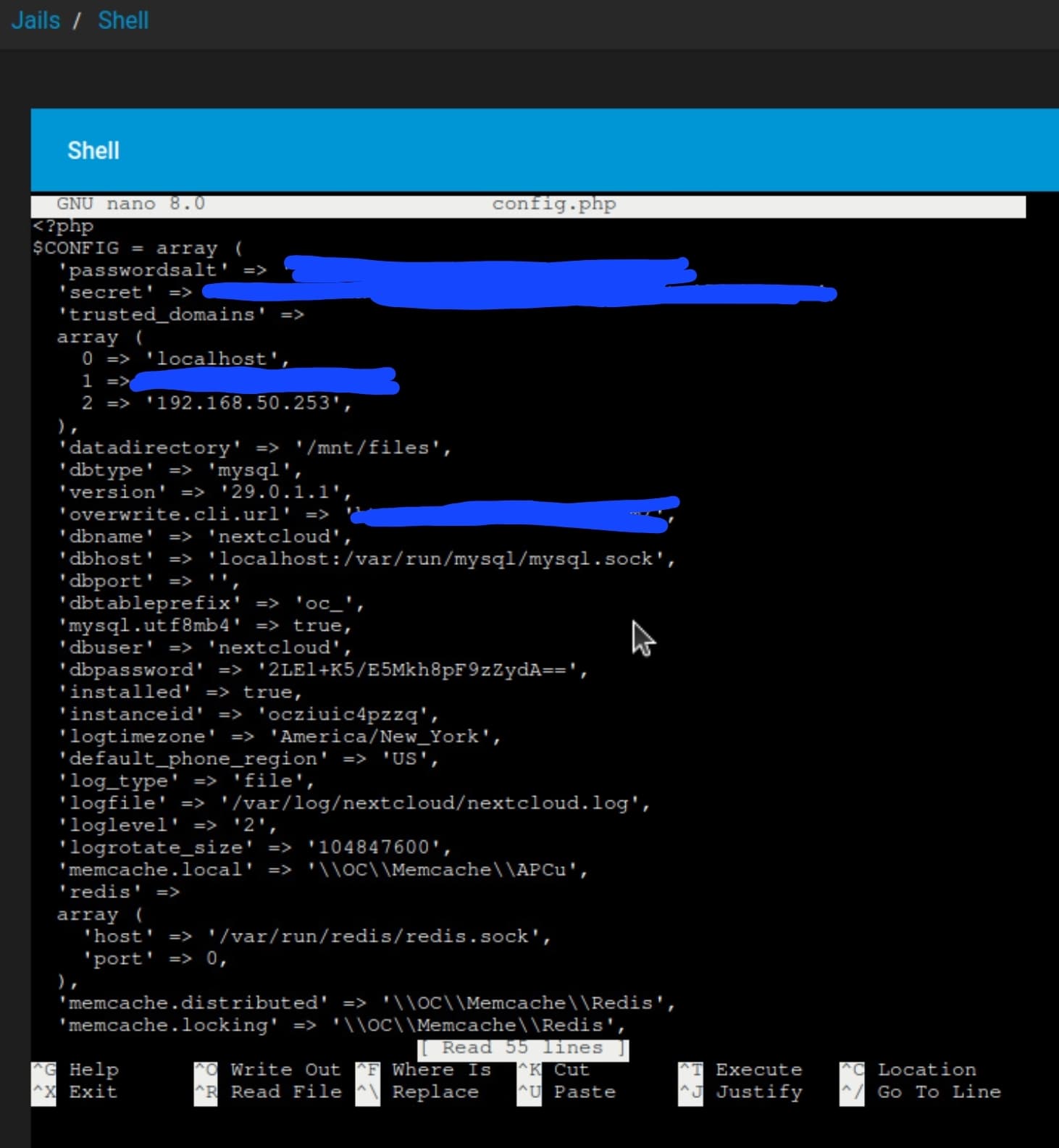

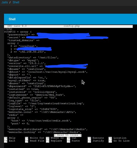

Deleted and reinstalled the jail again…here’s the nextcloud-config
Here’s the nextcloud/config/config.php:
I’d run it again. Also share your nextcloud-config file if you want.
Looks good. Is your domain resolving to the proper IP?
Nope, and that might be my own fault being an absolute noob to web dev and cloudflare.
But I can’t even get to the log in from my internal IP…
To do that you need to change three values inside the config.php file
overwritehost should be your IP

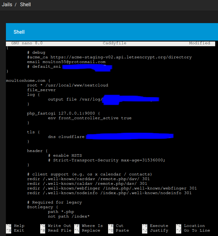

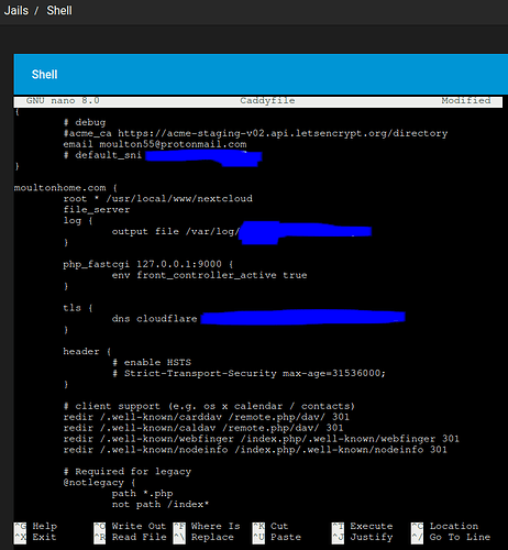

Then in the caddy file at /usr/local/www/Caddyfile change the site block to read
:80 {
nextcloud contents
Instead of having your domain
I’m not too sure where that should be written…sorry
edit: changed image
Right where it says moultonhome.com
Just remove that and write :80
And probably now you’ll have to reroll your DNS token as it is visible in the screenshot.
grabbed the wrong screenshot…buggers…
