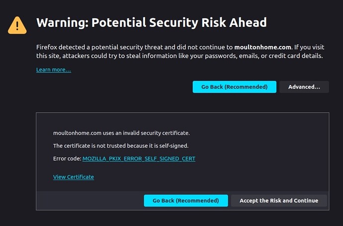

Turned off port forwarding and now I’m getting this error. Is this part normal?
Yes. That is the staging certificate.
Once you’ve confirmed it’s working, you can run the “remove-staging” command.

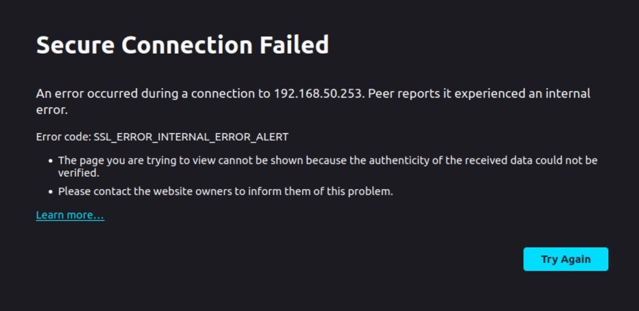

Turned port forwarding back on. It sends me to my internal IP I set for the jail, but with this web error.
I have the router set to send ports 80,443 to the nextcloud jail IP.

I am able to get past the “warning untrusted site, are you sure you wanna continue?” pages. Then it’s back to the error page above…
Can you share your current caddyfile and config.php?
