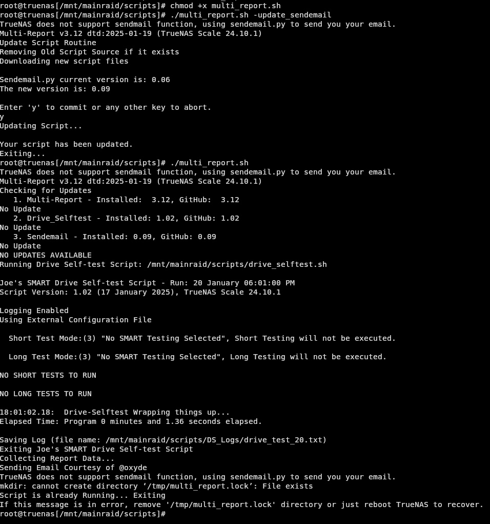

I’ve done something wrong. I get an error which says
"line 12: syntax error near etc. etc.
(please see below for full details).
A day or so ago I noticed the “0 byte” file size problem after I did a .multi_report.sh -update so, following this thread, I did a manual copy from github to the directory so that I see this when I do ls

when I then try to run it (having done chmod +x) I see this:
root@truenas[/mnt/mainraid/scripts]# ./multi_report.sh
./multi_report.sh: line 12: syntax error near unexpected token `('
./multi_report.sh: line 12: `Config_File_Name="$SCRIPT_DIR/multi_report_config.txt" set -E -o functrace failure(){'
This is using ElectricEel-24.10.1
Also - from my point of view this is not an urgent problem to solve, so please don’t divert anyone’s effort from the main body of work. It is likely - very likely - that I have done something stupid or forgotten to do something sensible.

You are using a failed version of Multi-Report.
Line 12 should read SCRIPT_DIR=$( cd -- "$( dirname -- "${BASH_SOURCE[0]}" )" &> /dev/null && pwd ) and has been in Multi-Report for years. This is the first time I have seen this failure message, interesting.
Please visit the GitHub site and grab version 3.12. (it is dated 19 Jan 2025).
Please let me know if that fixes or fails to fix the problem. Your multi_report_config.txt file should still be fine so you can retain that.
Once you have the new version, run it using the -update_sendemail to grab the most current sendemail script and -update_selftest to grab the most recent Drive_Selftest script (it should be current but better safe since it is only a single extra step)
Thanks, I needed that.

Success!
Looks like it is idiot proof after all. Thanks Joe!
