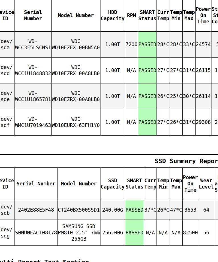

I received an email with a lot of successful results though, just like I used to get on Dragonfish until a week or two ago:
and so on.
perhaps those are results left over from previous runs but not emailed and not deleted subsequently?
These are currently logged results not updated by a recent test.
You can compare power on time with the last test type (time conducted). If there’s a (large) difference between the two times, you’ll know it’s been a while since a test has been preformed.

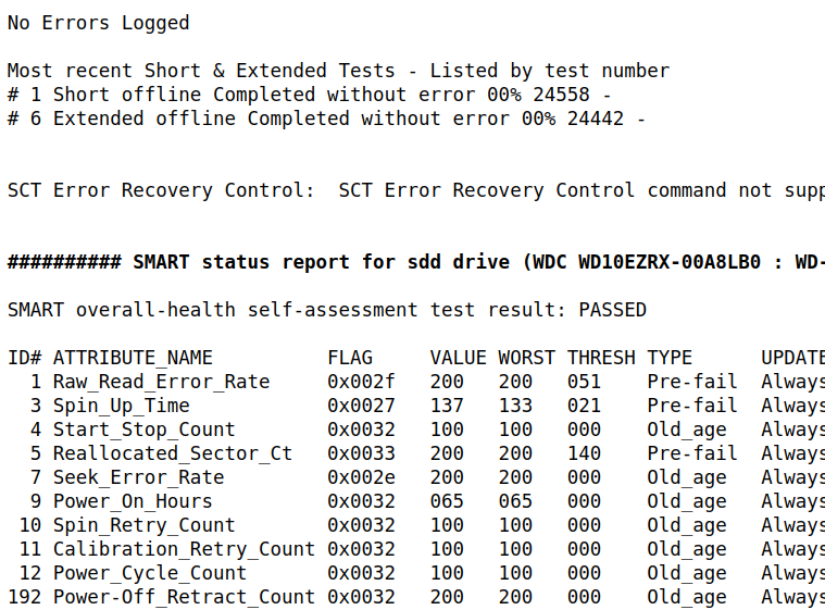

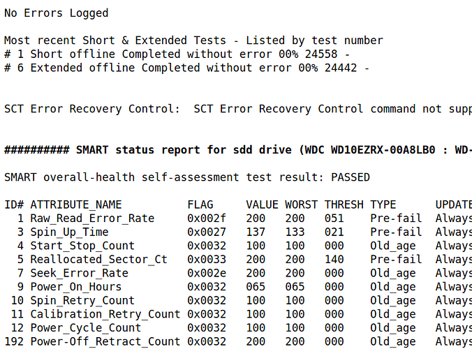

Ahh yes, I see it now: there’s a 16 hour difference between all of the times e.g.
Short offline (24558 hrs) vs power on time 24574
A small difference which makes me think that test was performed recently - presumably yesterday when I was messing around. But not immediately before I did today’s update so I do need to look at the options. Thanks; I wouldn’t have spotted that detail.
If I choose option 3 in the multi_report.sh script, presumably ought I to delete these?

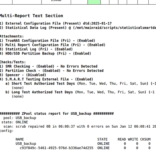

If I recall correctly (I may not) you were not getting the Text Section of the reports previously. Is that true? And now you are.
The default is to receive the Text Section. You can disable that in the config setup. But what you are seeing in Normal.
When using Multi-Report, you should only “need” to look at the email Subject line, if it says anything other than “Good”, then all that data is there to help identify the problem. It is a lot of data but it makes it easier to diagnose the issue.
And your normal email should say “Good”. If you have errors, send me a -dump email and in the message just ask me to give it a look. I typically respond fairly quickly. Sometimes a person has a few bad sectors and have not performed the automatic compensation adjustment.
