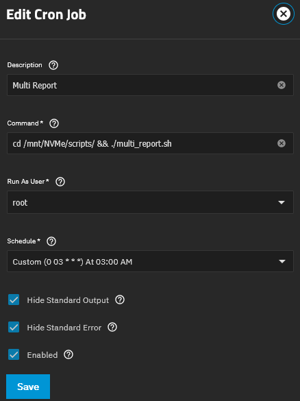

It is, I installed the script a few days ago and every time the script was run by cronjob I got the error.
Executed CronTask - cd /mnt/NVMe/scripts/ && ./multi_report.sh > /dev/null 2> /dev/null: sudo: process 13297 unexpected status 0x57f

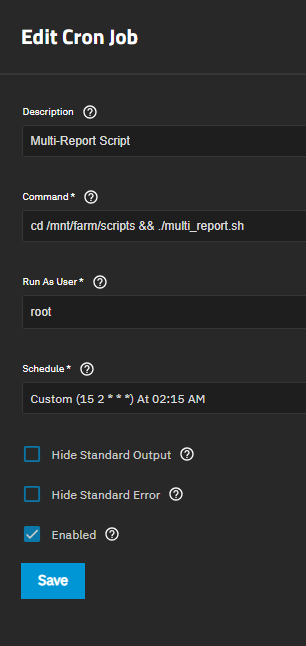

@Davvo Just to clarify how you are running the script:
Here is mine from TrueNAS 25.04.1, your Command line should be cd /mnt/NVMe/scripts && ./multi_report.sh and if it is different, then that is likely the problem. It is different from the CORE command.
