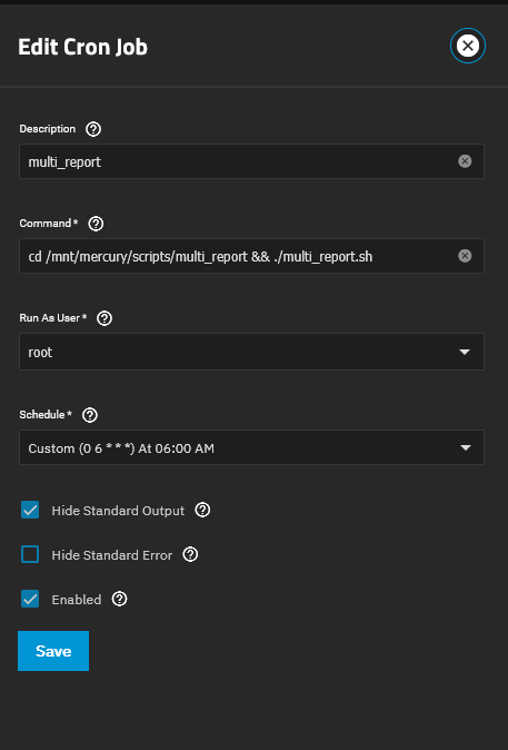

In relation to the new “unexpected status” error:
sudo: process 1458350 unexpected status 0x57f
Executed CronTask - cd /mnt/mercury/scripts/multi_report && ./multi_report.sh > /dev/null: sudo: process 1458350 unexpected status 0x57f
The script runs successfully (having debugged the FARM problem with @joeschmuck) but I just get the extra email/error
Running Truenas Scale 24.10.2.2
If you uncheck the Hide Standard Output, it may help identify the problem, or not. Feel free to forward me the email this generates so I can take a look.

For everyone experiencing sudo: process 379260 unexpected status 0x57f errors while running cronjobs on SCALE, this may be of help to you.
  1. log in as root into a shell;
  2. cd to your script location;
  3. ls -all *.sh
  4. Your files should look like this:
-rwxrwx--- 1 root root 104786 Jun 24 09:30 drive_selftest.sh
-rwxrwx--- 1 root root 620989 Jun 24 15:34 multi_report.sh
-rwxrwx--- 1 root root  10298 Jun 23 08:41 smr-check.sh
Mine were as follows:
-rwxr-xr-x 1 root root 104786 Jun 11 19:47 drive_selftest.sh
-rwxr-xr-x 1 root root 614674 Jun 11 19:24 multi_report.sh
-rwxr-xr-x 1 root root  10298 Jun 11 19:28 smr-check.sh
Even a chmod +x *.sh did not help, hence I tried a chmod 770 *.sh: this got the permissions right, and the error henceforth disappeared.
Thanks once again to @joeschmuck for bearing with my dullness.

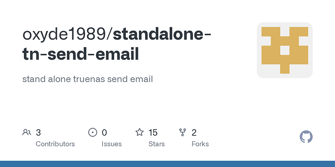

@joeschmuck are there any logs files relating to emails? I’ve been running the script on my TrueNAS Core servers for a long time now. And updating to the latest versions when released.
One of the servers now often doesn’t send the email updates. Either via the cron job or if I trigger it manually. The other server still sends them every day. Both are running Core 13.3-U1.2 and both running Multi-Report v3.19.
Are there any logs that I can look at to see why it might be failing?
I reply to you instead of @joeschmuck.
At first, check if sendemail is at the latest version using the flag from the multi report, if not update it.
Then, i have to say that by default the sendemail not collecting logs anymore, but you can test it standalone triggering an email, explained here:
don’t forget the --debug_enabled flag.
(if you grab the pre release, there is also the test mode available to quick trigger an email
python3 multireport_sendemail.py \
    --to_address "myemail@gmail.com" \
    --test_mode
let me know, and feel fre to dm me if wanna share logs file
@oxyde thanks for the help. I don’t think sendemail is required for Core. At least that is what it says when you run it:
Ok, i jumped into conclusion that MR on Core use sendemail on newest version but watching your screenshot i’m totally wrong :smile:
Must be only for Core users using the other Joe script (only the backup config one).
So, @joeschmuck , we need you
