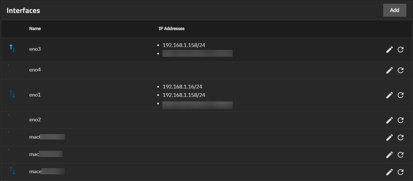

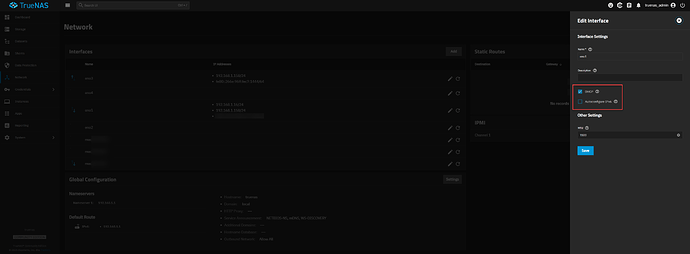

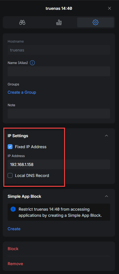

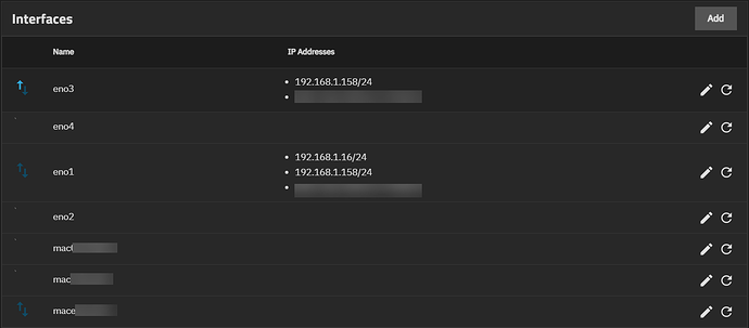

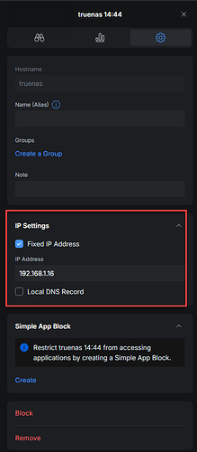

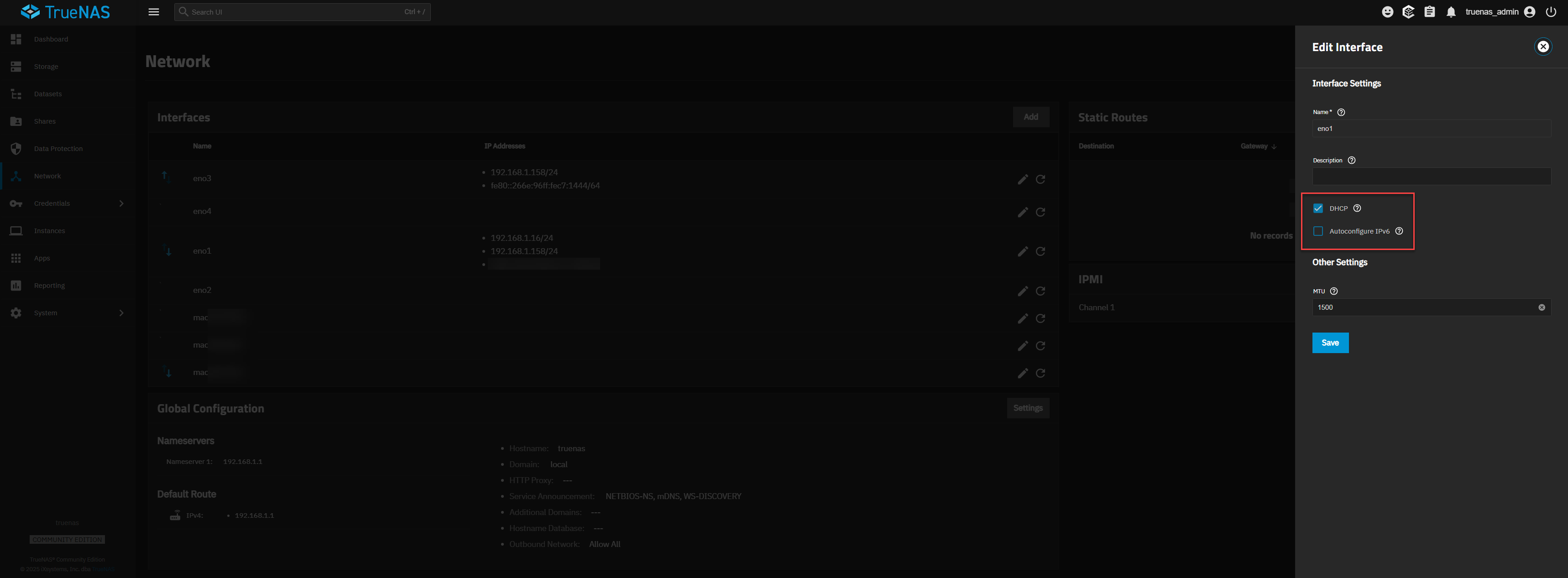

Not sure I’ve seen something like this. I have a 4 port NIC card in my TrueNAS, both en01 and en03 are plugged into my switch and live. In my Ubiquiti gateway, both are given fixed addresses 192.168.1.158 for en03 and 192.168.1.16 for en01 using Ubiquiti’s DHCP reservation. For some reason, the en01 device is pulling BOTH 192.168.1.158 and 192.168.1.16 which is of course throwing an IP address conflict on my Gateway. Since both are set to fixed addresses, I don’t know why this NIC would pull a second address. I also do not have any aliases on either of these NICs it literally should be just 2 NICs, 2 IP addresses. I have tried removing DHCP on en01 and using the alias for 192.168.1.16 but TrueNAS throws a warning that it’s already assigned because it was just assigned through DHCP.
