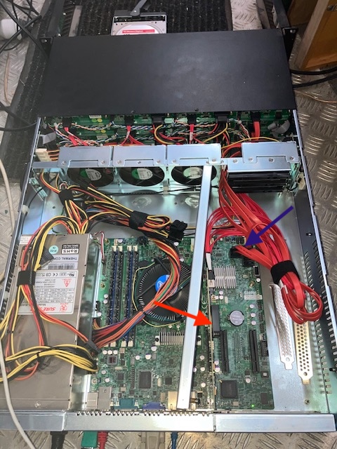

delving deeper, the Motherboard has ECC RAM. And looks like my HBA - an LSI 9211-8i (now confirmed flashed for IT mode) has 8 direct feeds into 8 of the bays - so I should be able to run SAS drives. Buying a cheap one for 15 bucks to trial out… then the plan is to get 8x 4TB 6Gb/s new SAS drives (“unopened”/unused) for around 65 bucks each… maybe a bit more. That sort of size enterprise seems to be going real cheap ATM… hopefully I can isolate which bays that HBA is connected to, in order to maintain an 8X ZF2 SAS pool… onwards and upwards!
HBA left (red arrow) should be able to manage SAS drives. Drive bays connected direct into MB (SATA) right (blue arrow)
