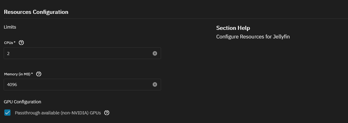

I edited Jellyfin App, toggling " Passthrough available (non-NVIDIA) GPUs" option

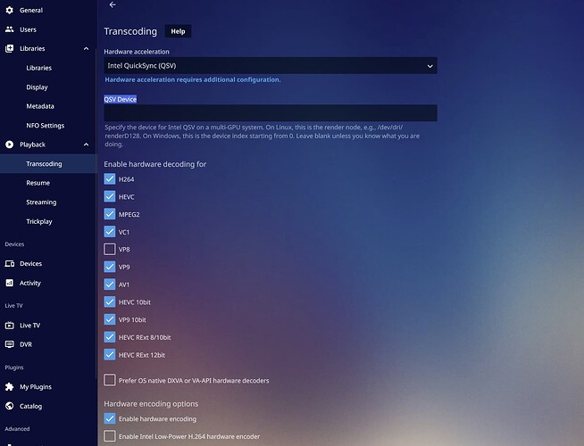

I then, went back to my Jellyfin installation, toggling the INTEL QSV Hardware Acceleration, without filling “QSV Device”.
I assume that my set up is not finished (I don’t know how to fill “QSV Device” for example).

This is my jellyfin configuration in TrueNAS
This is how I set up my Jellyfin server transcoding:
I know that QSV Device is empty, I just don’t know what to fill it with.

I have no use for HW acceleration myself but I searched around a bit and what I found suggests this could be related to insufficient permissions passed to the Jellyfin Docker container.
I am not sure how one would go around verifying that with the official App, much less whatever that passthrough option is supposed to do and if it’s working as it should.
Had to reapply owner/group recursively and to child dataset after starting the SMB share.
I don’t really know how to explain, but it’s working now.
