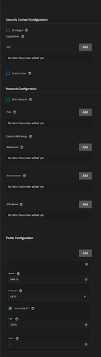

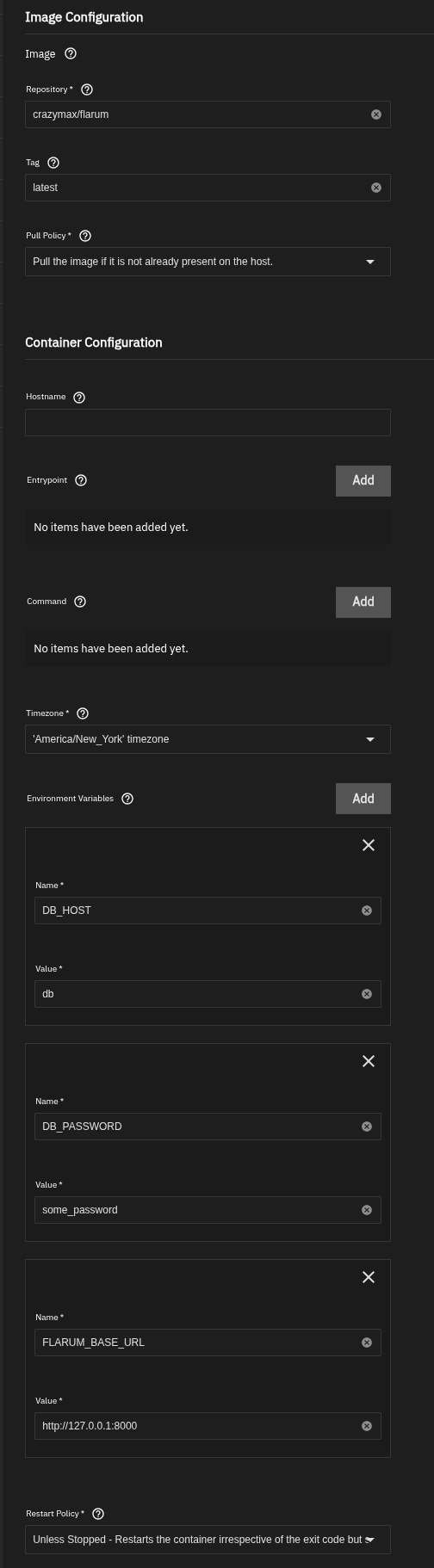

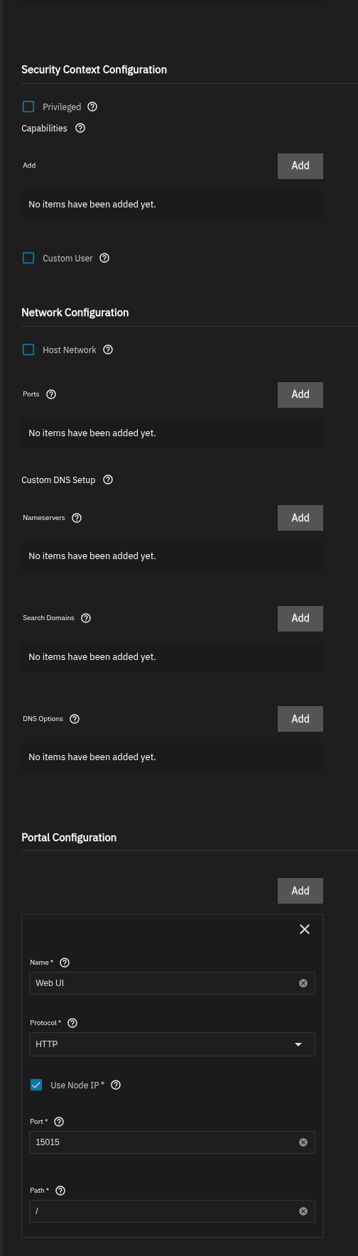

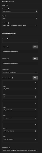

See subject line. Using crazymax’s flarum Docker image on Scale 25.04.0. At this point I cannot access the portal UI. Here’s what I have so far:
What am I doing wrong please?

Not going to get an eyestrain headache trying to figure out the screenshots. Do the custom app from YAML, and the provided Compose file:
I prefer Compose via Dockge, but this ought to work as well.
Just click on the screenshots, and they will expand. Otherwise, I do not know how to “do a custom app from YAML,” I’m afraid. Where do I find this YAML file?
It’s the file dan posted and next to the custom app option click on the 3 dots to open the window where you have to paste it to.
