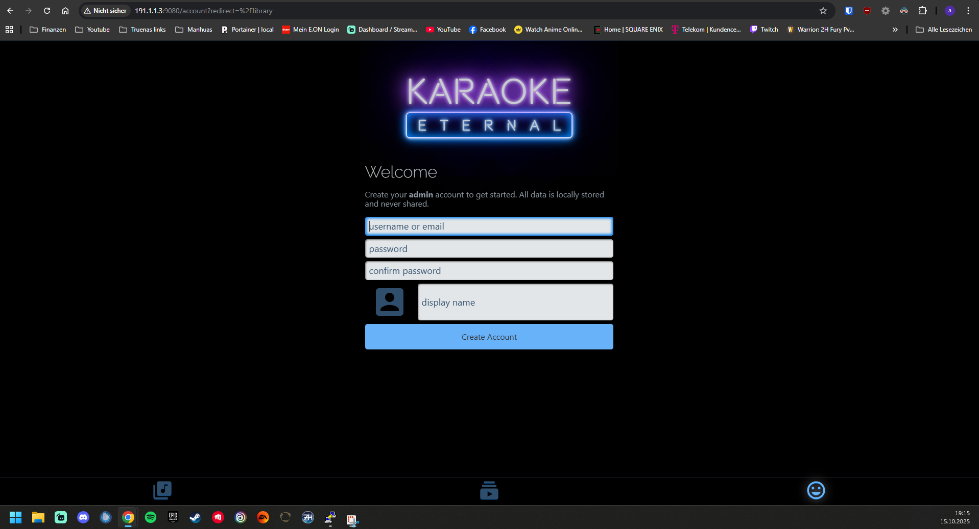

well, i just gave it a try with the yaml from their homepage and it’s up and running
services:
  karaoke-eternal:
    container_name: karaoke-eternal
    image: radrootllc/karaoke-eternal
    ports:
      - '9080:8080' #9080 is the port on the host and 8080 in the container. 8080 should not be changed
    restart: unless-stopped
    volumes:
      - /mnt/Plugins/test:/config
x-portals:
  - host: 0.0.0.0
    path: /
    port: 8080
    scheme: http
Edit: Added the code for a webui button
