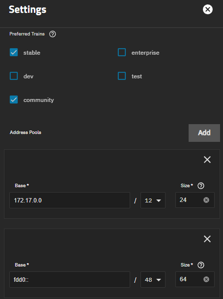

This is a docker bridge network by looks of it. Usually these have an address in the range of something like 172.17.0.0/16 or similar.
…which raises the question, did you change your address pool (see below)?
If so, I’d bet good money that’s your problem.

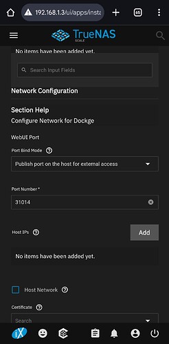

Where is that screen? The networking section only has the main system IP.
I am familiar with dhcp, DNS and setting ups etc, but can’t figure out this strange behaviour. That br listing is my best guess, but it could be unrelated. Is it something I can delete or at least comment out directly in a conf file in shell to test and see what breaks?
It’s part of the apps settings.
None of the apps in truenas apps section have the IP directly.
Actually, I remember now I was trying to get frigate to work after moving hosts, and I did try adding a bridge to the networking through docker compose in dockge, and I put in the local network, which was a mistake apparently, but that config is gone so I’m not sure why the br interface still exists or how to clean it up
