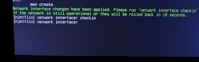

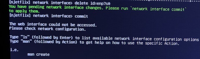

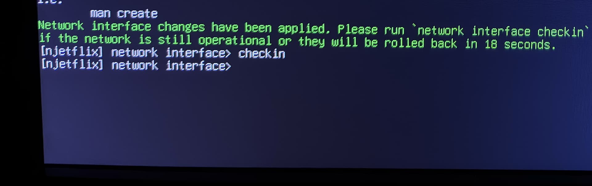

I wanted to delete the interface. However, this was not possible as there are still unfinished changes (see image). Unfortunately, I find myself in an endless loop. When I complete the changes and then want to delete the interface, the message that there are still changes appears again.
Is it possible to eliminate the endless loop?
After commiting the settings, my router goes out of service.
Deleting interface does not in the menu. same loop.

Yes. Truenas was disconnected all the time. I tried deleting the interface on console with cli. But it didn’t work. Read post above.
