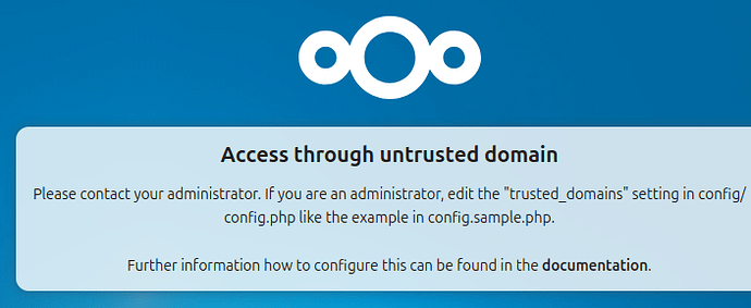

i have NC running but am confronted with the message
how do you correct this? how do you get to the config.php?

So I don’t give up easily. I ended up finding this solution which worked for me. Editing the config.php apparently is ignored by NC… Adding Environment Variables to the App installer resolved it for me.
  • removed entry in “Host”
  • added “Additional Environment Variable” OVERWRITEHOST with Value 192.168.178.28:30027
  • added “Additional Environment Variable” OVERWRITECLIURL with Value https://192.168.178.28:30027
  • set Certificate ID to use the freenas_default Certificate.
192.168.178.28 is the IP address of my Truenas scale installation. 30027 is the port I’ve also set in WebUI Port.
Hope this helps someone else.

Thanks!!! This fixed my failing install. I did remove the pgdata dataset and remade as Generic and set automatic permissions on the added host path.
