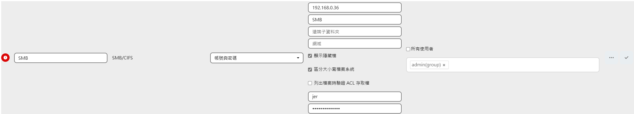

I already install smbclient APT Packages
but when i mounts the local SMB on external storage space
I get Misconfiguration message
I already try same username and ip on windows smb, it’s right
The same disposition on truenas scale 24.02 can work,but when I updated to 24.10.2 it didn’t work
So it’s seems like your trying to mount an external SMB share on Nextcloud.
Have you tried removing all the extra fields and just trying the IP address and share name? Also looks like your domain is populated is that correct?
Hello, I just populated the IP address and share name
Ah ok I could see some characters in the other two fields.
I guess you’ve clicked the tick and entered your Nextcloud password again?
Is SMB the name of your share?
Yes my share name is smb
on windows i can use \\192.168.0.36\smb and same password to connect

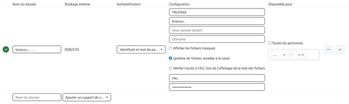

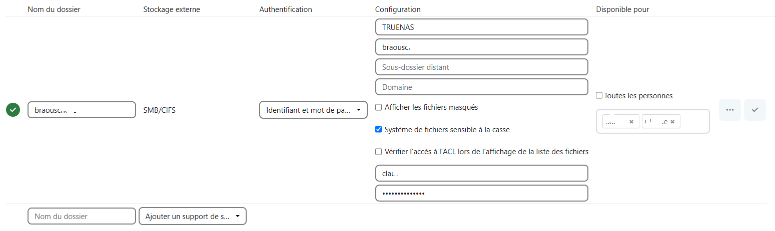

I have nextcloud installed on truenas scale 24.10.2 with an SMB share mount and it works great.
You must have another problem.
Difference with you, instead of the local IP address I have the DNS name (TRUENAS)
wow, i try to use dns name then its work
i think it because on docker it can’t find 192.168.0.X network
