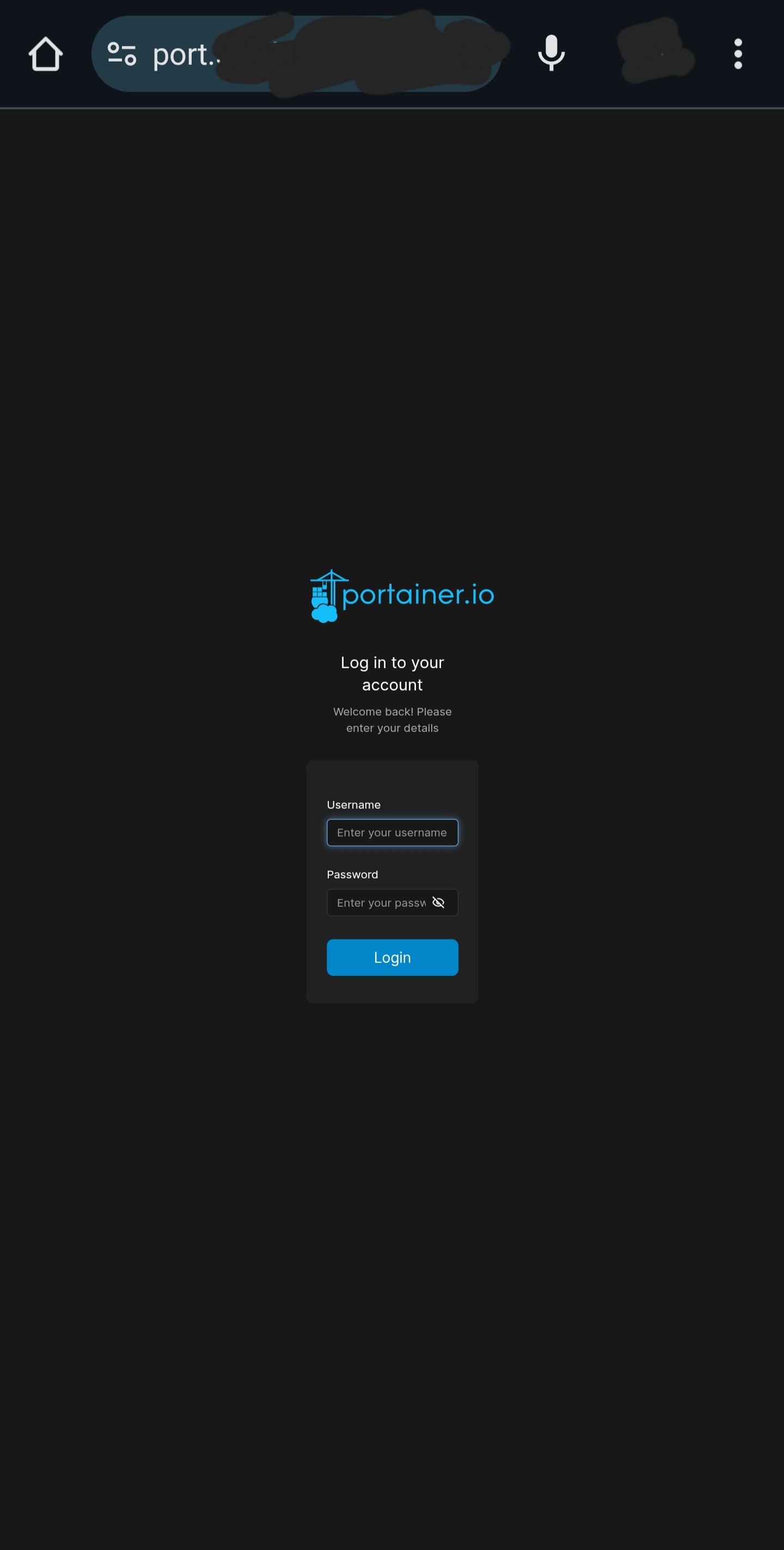

Nginx creates a cert for accessing a webui via a domain name say,
Eg, I’ve setup Nginx to use my domain name internally to access my applications, one such is Portainer for example, I’ve it setup as port.mydomainname:
This screenshot from my mobile shows a cert installed while connecting to Portainer through nginx whereas;
This screenshot, on the same mobile device afew seconda later, connecting to Portainer though IP:Port does not have a cert, I could be wrong but I dont think Nginx saves the cert on the device but only while being routed through Nginx with a domain name.

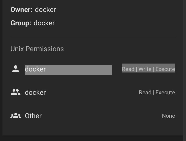

Just check the permissions again. Only the owner can have read and write permissions on the dataset where NPM is saving the certs; even the group has to be read only. I also had to change the permissions on the dataset back to UNIX (but that does make things easier to set). It has something to do with certbot not allowing a certificate to be created if someone else can change it. (but Im definitely not an expert)

okay - so set your UID to be the same as the owner of the dataset you have used for “Nginx Proxy Manager Certs Storage” in your setup. And then make sure that the permissions on your dataset are = owner Read/Write/Execute; owner Read/execute; other none
Yep Lets encrypt will verify each time (and eventually time out); this is a saving issue and certbot wont save it to your folder if anyone apart from the owner can write to the save location
The owner is root and I have set the UID\GID to 0 in the app settings. Same error.
Again, not an expert, but root does have special priveleges and I am not sure if you can ever stop the root GROUP from being able to write. Change your UID to something else. I have a user named “docker” this is what my permssions look like (i think its 755 but youd need to check)
