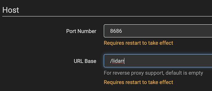

It’s always just one IP; that’s why you have a reverse proxy. The “Base URL” setting tells the app in question that there’s a path prefix (and it goes by a variety of different names). Here’s how it would look for Lidarr:

Some software doesn’t support this, and needs to be hosted at the base directory–that isn’t a limitation of NPM, but of the software itself–Duplicati is one such piece of software I ran across.
