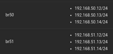

My (24.10.2.2) System has multiple bridges with multiple aliases:
Using “Bind Interfaces” to those bridges, it opens up the SSH ports for all addresses there:
