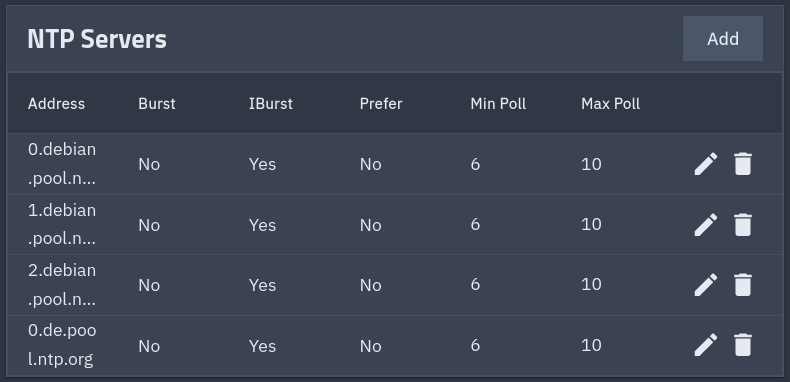

I have the same issue.
I added 0.de.pool.ntp.org Will this resolve the issue?

I see. I do have us.pool.ntp.org added as the first NTP server beside the debian server. Maybe you can try it. If you’re not in US, going to https://www.ntppool.org and look up one that will work for you.

I added 0.us.pool.ntp.org as the first NTP server besides the default debian servers, and stop putting the system to sleep seemed did the trick. I havn’t encunter this NTP peers issue since December post.
