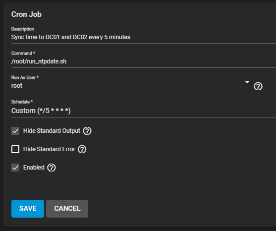

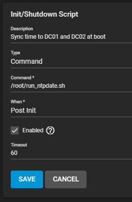

I was never able to determine why ntpd appears to be correctly configured but does not adjust the clock. Ultimately, I set up a cron job for ntpdate to run every five minutes. While this is less than ideal (~20ms adjustments via “slew” every 5 minutes, rather than continuous correction), it will suffice for the purpose the server is intended for. I wish I was able to determine what the issue was.
For the sake of posterity, here is the script and startup/cron tasks I use to keep the time in sync with our Active Directory domain controllers. The first time the script is run (on startup), it stops ntpd and steps the clock via ntpdate. On subsequent runs (every 5 minutes), it slews the clock via ntpdate. This is obviously not ideal solution (which would be for ntpd to work correctly), but it does the job.
run_ntpdate.sh:
#!/bin/sh
NTPD_PIDFILE=/var/db/ntp/ntpd.pid
if [ -f $NTPD_PIDFILE ] && ps -p $(cat $NTPD_PIDFILE) > /dev/null ; then
	service ntpd stop > /dev/null
	ntpdate -b DC01.DOMAIN.AD DC02.DOMAIN.AD > /dev/null
else
	ntpdate -B DC01.DOMAIN.AD DC02.DOMAIN.AD > /dev/null
fi
