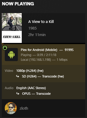

Something strange here…. the GPU is being recognized and is configured for NAS:
| NVIDIA-SMI 570.172.08             Driver Version: 570.172.08     CUDA Version: 12.8     |
| GPU  Name                 Persistence-M | Bus-Id          Disp.A | Volatile Uncorr. ECC |
| Fan  Temp   Perf          Pwr:Usage/Cap |           Memory-Usage | GPU-Util  Compute M. |
|                                         |                        |               MIG M. |
|   0  NVIDIA GeForce RTX 5060        Off |   00000000:01:00.0 Off |                  N/A |
|  0%   37C    P8              4W /  145W |       3MiB /   8151MiB |      0%      Default |
|                                         |                        |                  N/A |
It is configured at the App level:
However, from Plex, it is showing up as Unknown device.
But hardware transcoding works….
Does Plex perhaps use its own internal DB rather than querying PCI devices? If so, probably a result of not having an entry to map 2d05 to a text result.
Plex does not query PCI devices. Maybe the fact that the docker sees a GPU is enough, even an unknown one?
