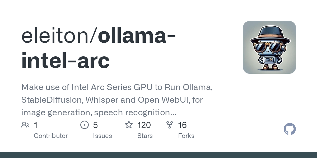

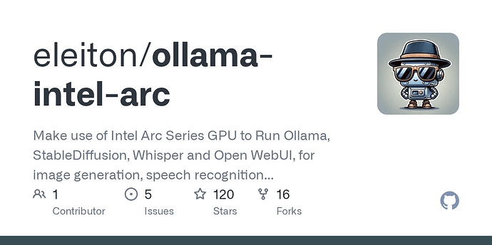

Biggest issue for Ollama users is that it doesn’t support Intel GPU’s, so a drawback for anyone using older nvidia cards for AI stuff
Pretty sure that there’s a fork of Ollama with Intel support.
Maybe I can bug @kris to talk about his, although I don’t know if he’s still using it? :wink:

Yeah I know of the fork, helped a guy on Discord about it, see Discord, but he was confused why his CPU was getting hit hard when using the Catalog app, just an FYI on a searchable thing (aka here) in case people are wondering
No, I gave up and went with an nvidia card locally. The forked version when I was testing was just too unstable and inconsistent. Granted, that was 6+ months ago, so could be a different situation now.
