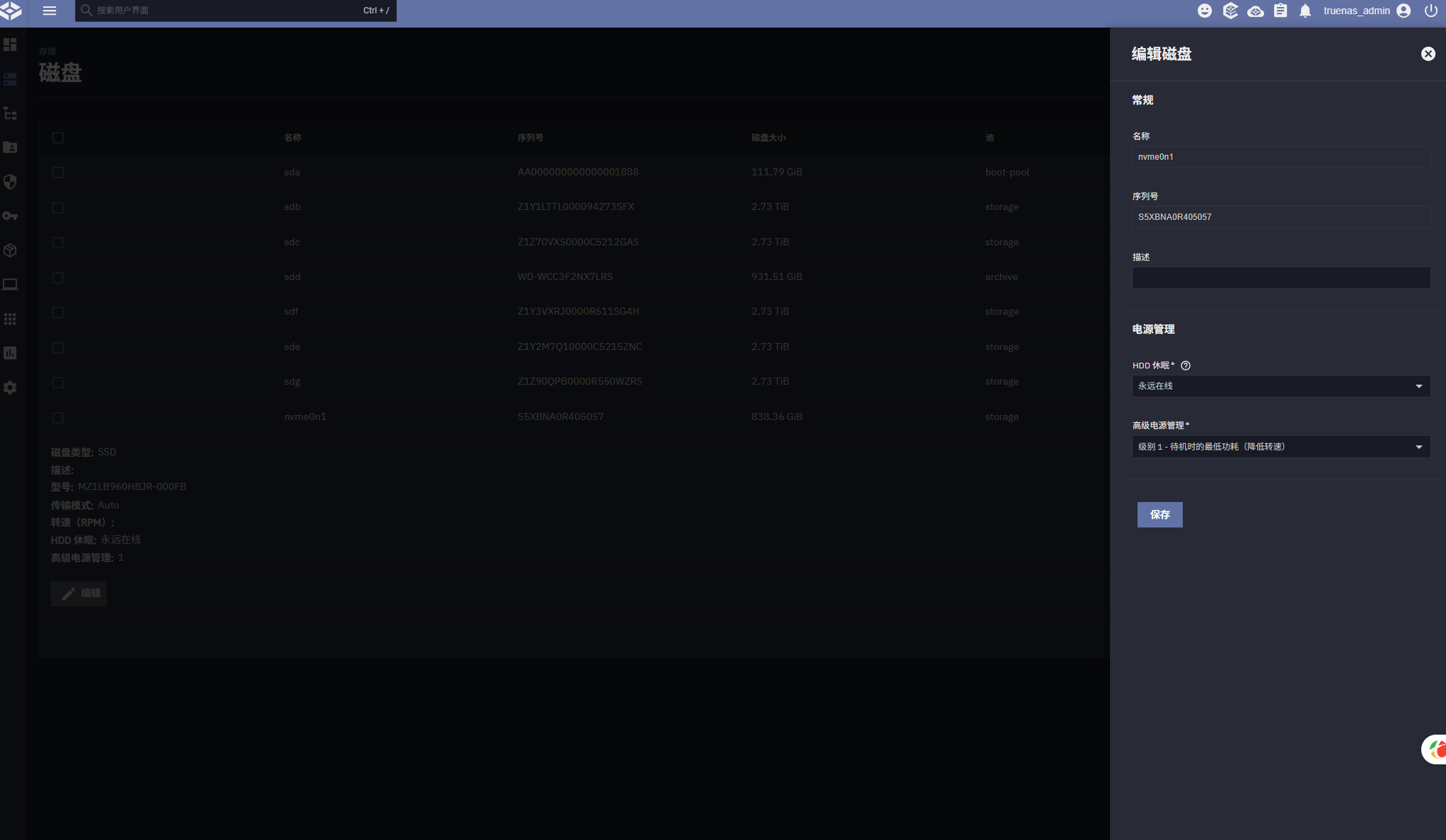

why i cant set alert temperature?
I’m guessing the version of TrueNAS you are running is different from the original poster.
