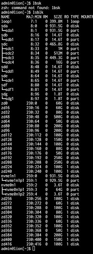

Mind sharing output of:
lsblk
dmesg | grep -i nvme
zpool status
Any other details on what kind of motherboard, what nvme drives, how they are connected, etc. etc. etc. could also be of use.
Edit: apply sudo as needed to get outputs.

lsblk shows other things, as far as I can see not related (for those problems see my previous two posts)

I realize that:
  • I am sure both devices are seen in the bios
  • however also not on OS level … I think …
See picture below
