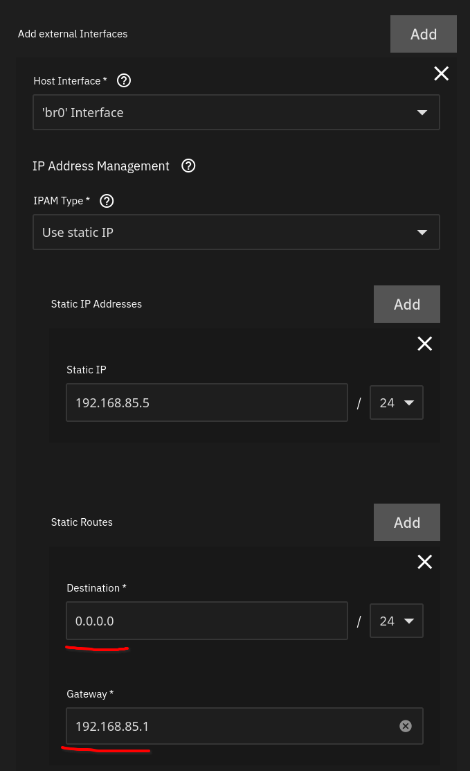

Au contraire, a Custom App is exactly how you solve it.
Add a static IP address of your choice to your Custom app. It won’t have the above 9000 limit.
So the solution is to give the docker app a different IP other than TrueNAS. I give this a try later. Thanks.

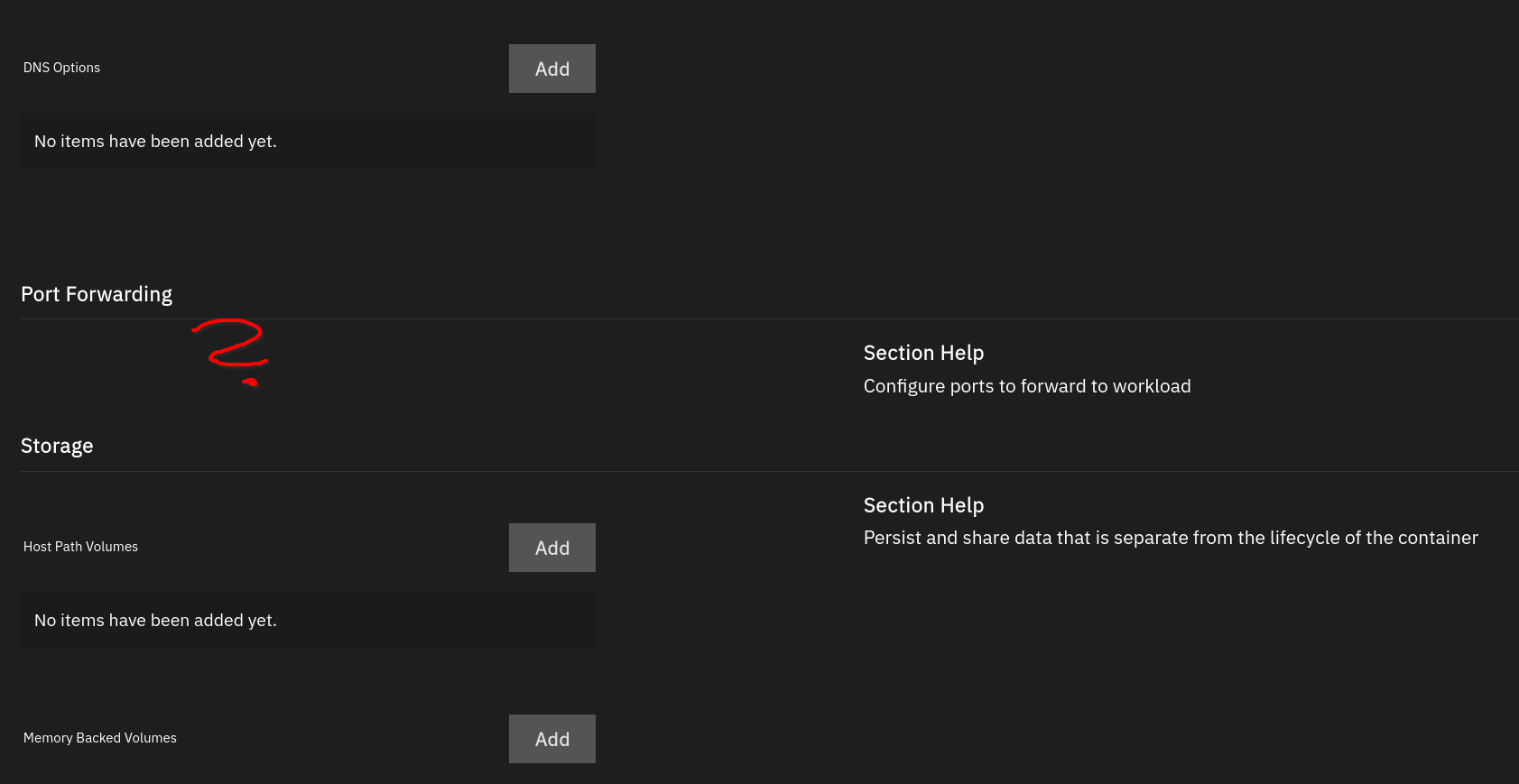

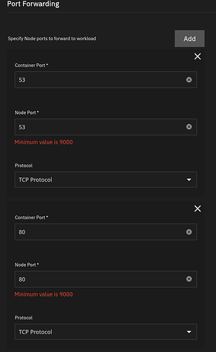

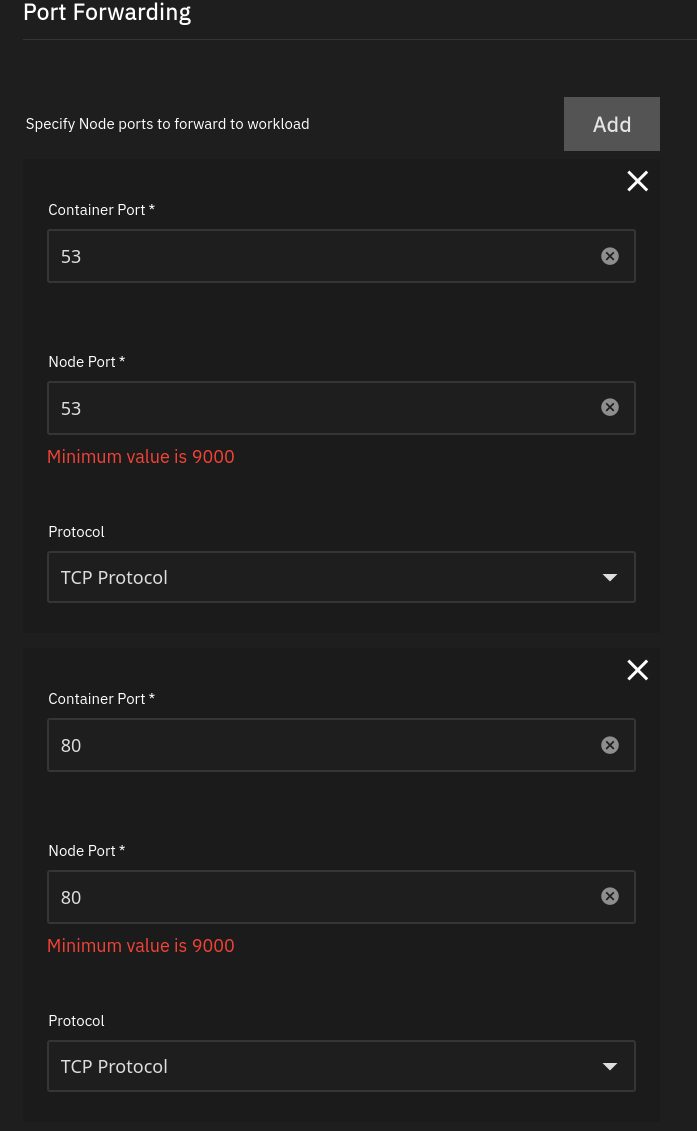

While adding a new Custom app with static IP, I don’t have the options to add port forwarding.
After saving the new app and going into Edit mode, I can add the Port Forward, but again, the form validation prevents me to add a port below 9000.
Got it working.
Had to add static routes.
No port forward necessary.
No port forwarding should be necessary, since the app has it’s own IP.
