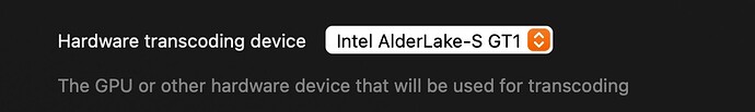

As I looked into it I noticed I had 5 current stream clients in plex, a few of which were transcoding, none of which seemed to be using hardware transcoding. I checked the plex settings, and it was turned on, and I even forced the transcoding device to the Intel AlderLake device:
But it continues to not use hardware transcoding. I installed intel-gpu-tools and ran intel_gpu_top and got the following:
