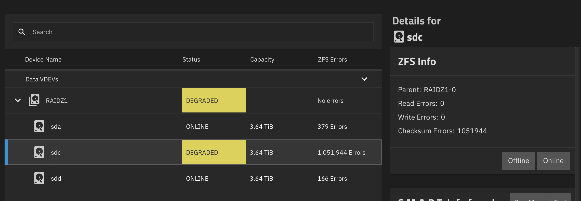

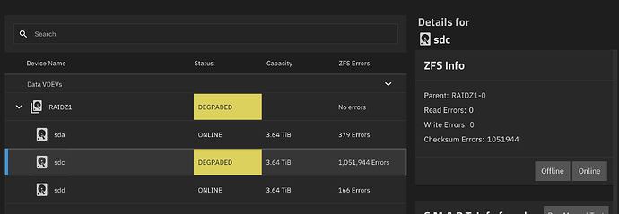

I am seeing my pool as degraded now after being on 25.04.0 for a relatively short period of time and I’ve noticed others are having similar issues.
At fist I thought I had a disk going bad but all of the smart tests pass without an issue. Also, if I reboot the system, the degraded disk seems to change every time. Sometimes it tells me the disk is degraded, other times it tells me the disk is faulted.
Here is what I’m seeing right now…
Any idea where to start?

One million errors is a pretty severe amount. Can you share the disk detail pane on the right to show if it’s Read/Write/Checksum?
Something like this is usually related to a controller or cable failure. Check for loose or damaged cables, as well as dirty contacts.
I will do that…

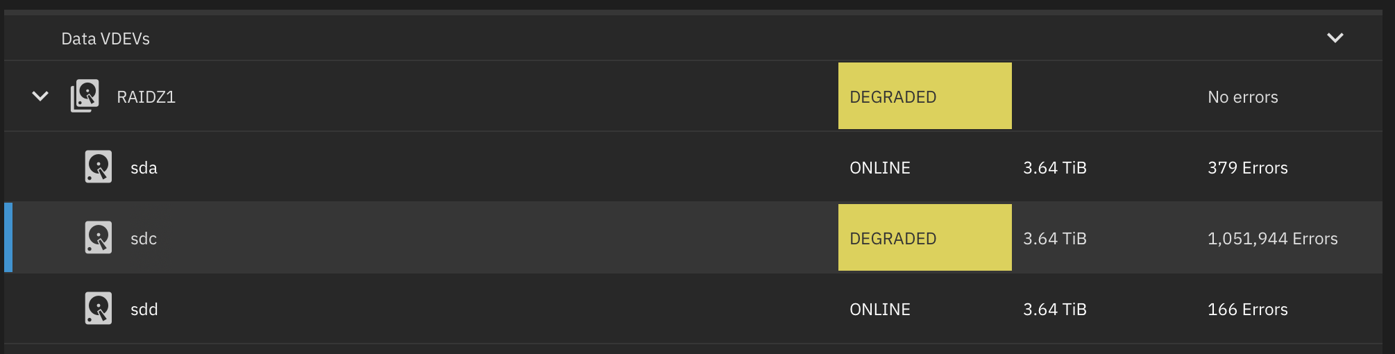

Here’s what the details say… It’s all checksum errors…
Checksum errors usually are symptomatic of things like cabling and connectivity - either data or power.
Check for obvious faults at the physical cable level, and then we can have a look at the tail end of dmesg to see if you’re seeing device resets.

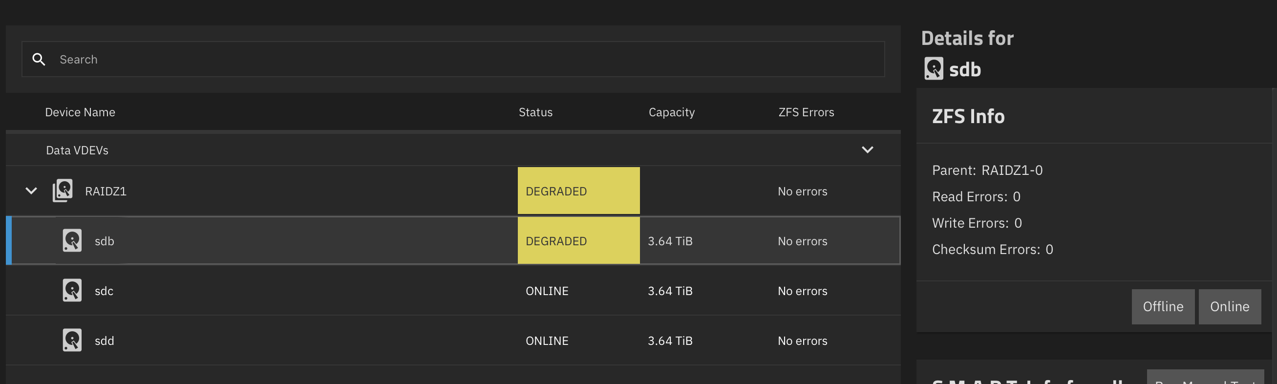

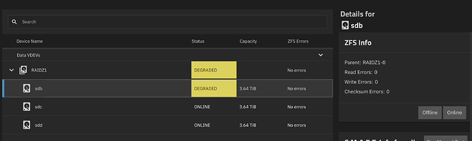

So, I’ve bypassed the backplane and have everything wired direct. The pool is still showing degraded, now on “sdb”. Here what it shows. No errors…
I’m running a SCRUB right now, but I’m not sure if that will do anything. I’m not sure why it is showing “Degraded”…
Thank you!
So the scrub is about 90% done. The drives are now showing…
sdb = 762
sdc = 146
sdd = 762
So, I’m guessing there is something else going on…

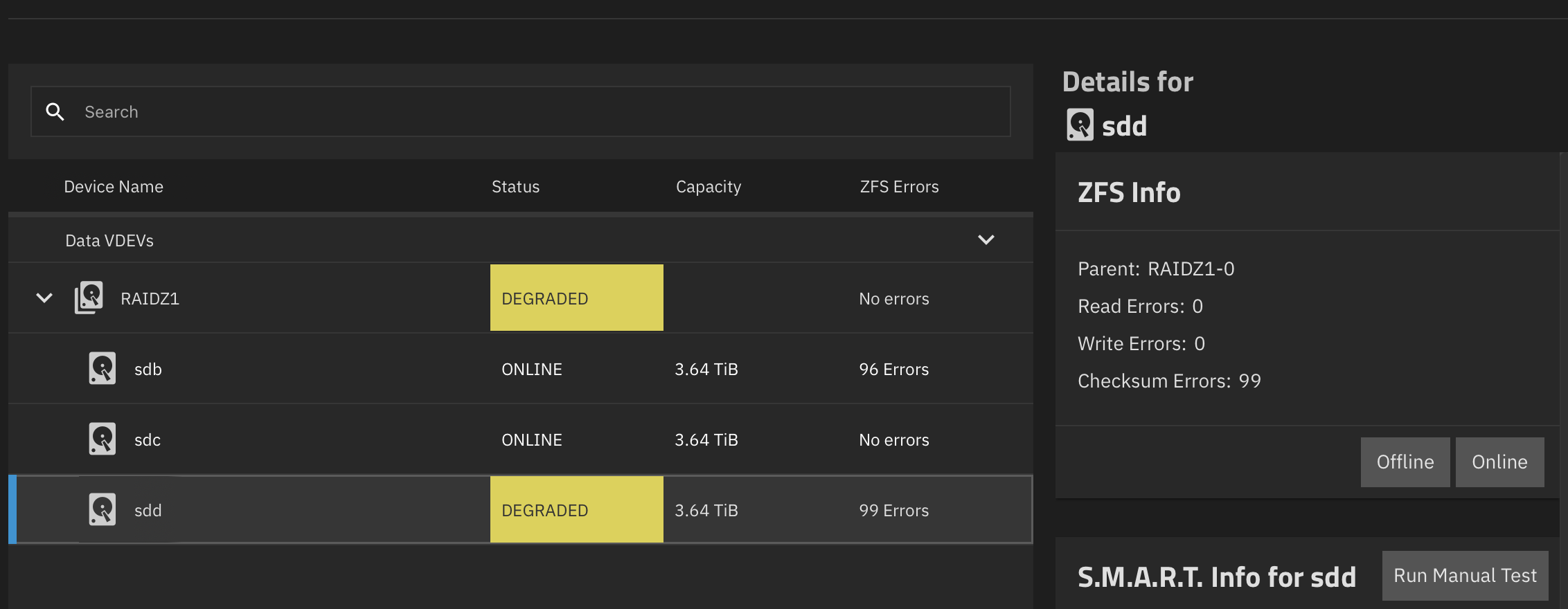

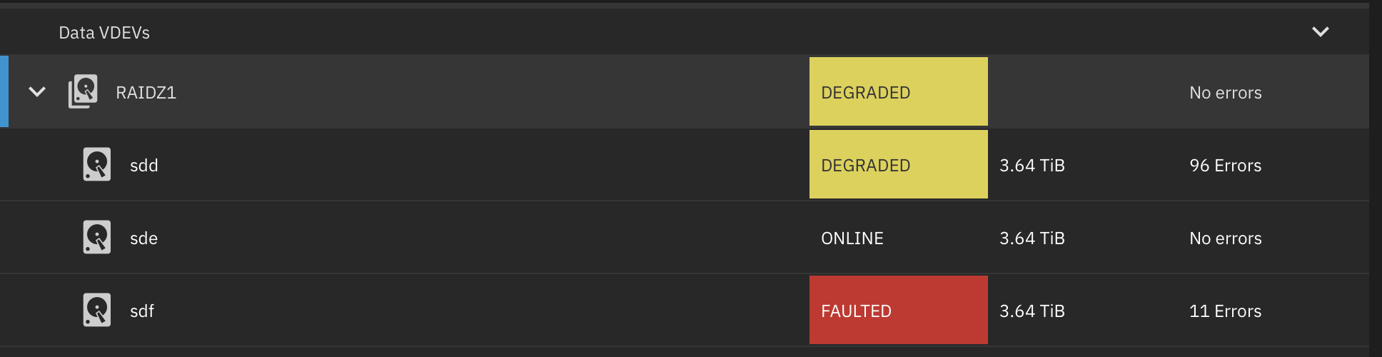

Is anyone else having this type of issue? I am really thinking this is a glitch. Like @rc722 , I pulled all the drives and ran WD software on them to check each disk. They all passed with no issue and no issues on any smart tests within TrueNAS.
I also added a secondary SATA card just to check if there might be an issue with the onboard controller, but the card had the same issues…
I’ve also tried multiple different SATA cables… Brand new and used…
It is also odd that I am seeing identical checksum errors on 2 drives with the 3rd showing something different. It’s not always like this but more times than not…
Also, the “degraded” drive is not always the drive with checksum errors. Sometimes, I see errors on the other 2 drives and ZERO on the “degraded” drive.

[ 4512.757927] sd 5:0:0:0: [sdf] tag#1 FAILED Result: hostbyte=DID_OK driverbyte=DRIVER_OK cmd_age=0s
[ 4512.757935] sd 5:0:0:0: [sdf] tag#1 Sense Key : Illegal Request [current]
[ 4512.757942] sd 5:0:0:0: [sdf] tag#1 Add. Sense: Unaligned write command
[ 4512.757948] sd 5:0:0:0: [sdf] tag#1 CDB: Read(16) 88 00 00 00 00 01 d1 c0 bc 20 00 00 00 e0 00 00
[ 4512.757953] I/O error, dev sdf, sector 7814036512 op 0x0:(READ) flags 0x800 phys_seg 28 prio class 0
This drive is now showing “Faulted”…
The plot thickens…
