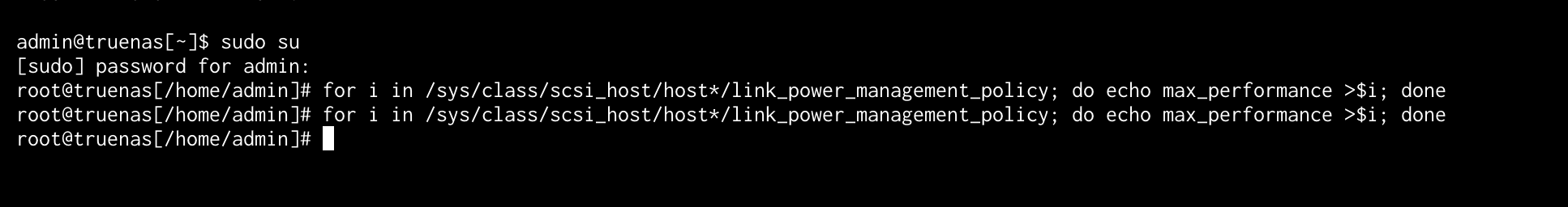

Elevate to a root shell with sudo su and then try:
for i in /sys/class/scsi_host/host*/link_power_management_policy; do echo max_performance >$i; done
Unless it’s a really low-quality 700W that can’t actually deliver, 3 drives shouldn’t be anywhere near enough to upset that drive. What we’re doing with the script above is setting the policy on the SATA link itself to never go to a sleep/idle state.
This time it didn’t return anything. I ran it 2x to make sure I did it right the first time…
Thank you!

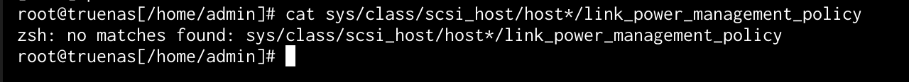

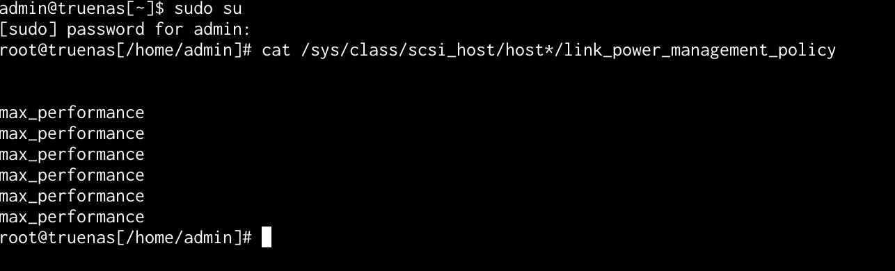

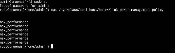

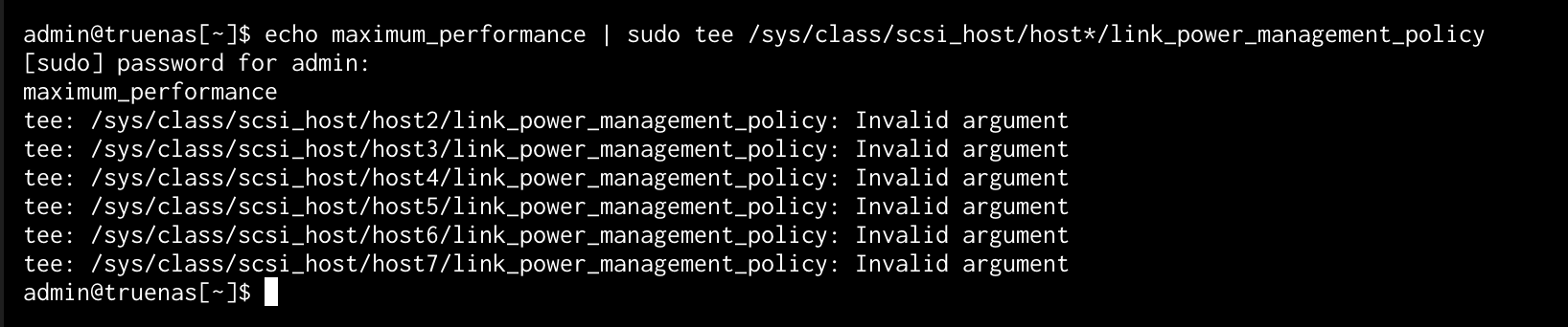

That should mean it took - you can check with
cat sys/class/scsi_host/host*/link_power_management_policy
And see if it comes back with maximum_performance for all of them.
It returns this…
Thanks for the help!
I’m running a Scrub right now.
OK, figured out what was wrong. missed the “/” at the very beginning of the location… Now I get:
Exactly what you expected…

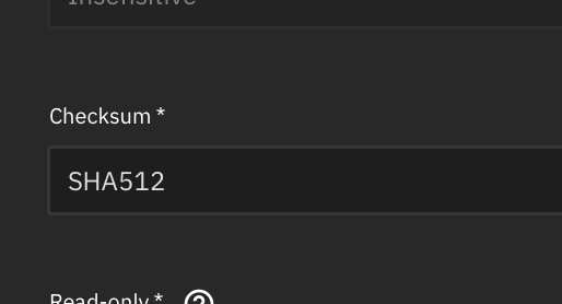

I saw in the Truenas documentation that the checksum setting in each of the datasets should be set to “SHA512”. Do you think that is correct. I went ahead and changed all mine, but it seems to have made it worse instead of better…
