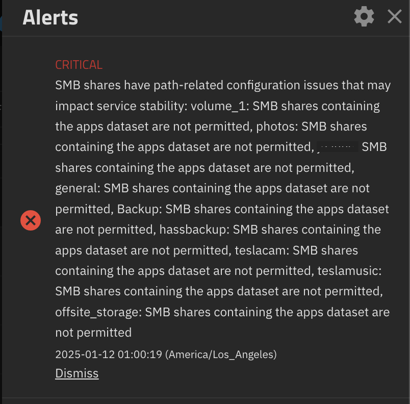

There are not many posts on this topic, in googling I keep coming back on this constant loop of finding the same posts over and over. After running a while, I got a critical error:
Googling this error, it suggests that I should not be sharing the ‘/mnt/HDD’ path - and I am not - all my shares are at: ‘/mnt/HDD/’

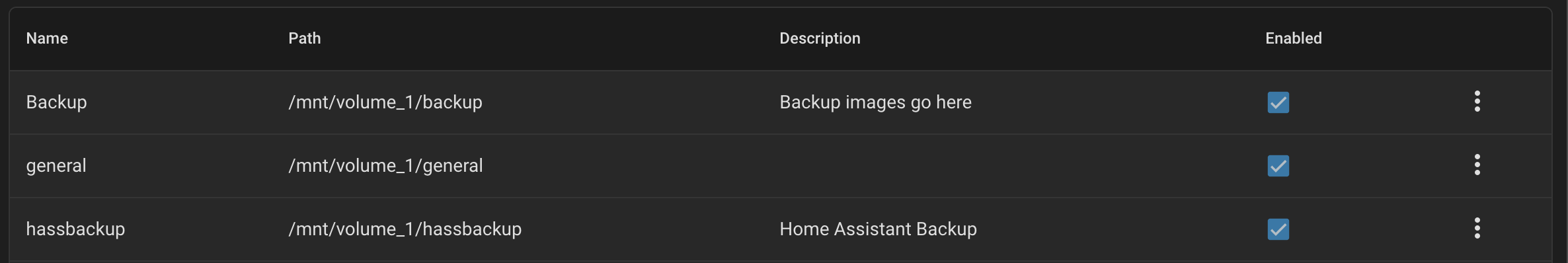

An example of my shares is:

What exactly does this error mean?
It mentions the Apps dataset.
Are you running Apps… after migrating from CORE? If so, we’d recommend upgrade to 24.10 - electric Eel
Where is the Apps dataset?
Not running any apps yet. I went dragonfish because I was a little worried about Electric Eel being bleeding edge, but if that’s a recommended path then I will do that right now.

Looking at the apps dataset, it was blank. I set it to “volume_1” this seems similar to the issue I had here:
Probably cruft carrying over from originally starting out on Freenas 11.1. I think I might have to crawl through everything that is “blank” and define it.
I think the apps were undefined, causing the error? Now I have a whole host of similar errors… Wheee! Upgrades are fun.

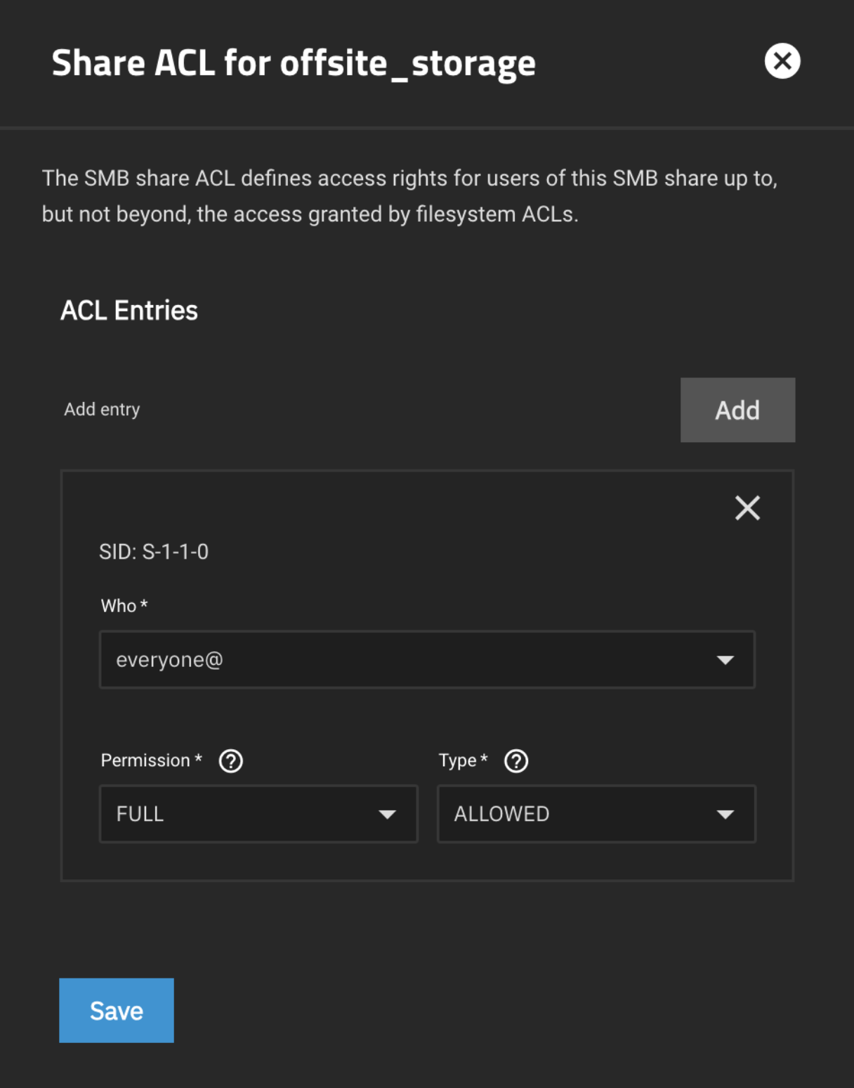

Well, something definitely did not port over. Looks like all my ACL settings are now blank, probably the cause of the new error:
Will re-define them. I know for SURE these had specific user permissions in 13.06, because I needed to isolate the shares.
