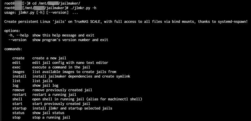

the jailmaker instructions for this is a bit, yikes scary :joy:

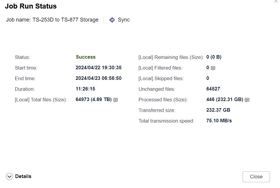

anyway waiting for the rsync job to complete shouldn’t be long. i had to redo it because i forgot to enabled change permissions to destination settings. which caused sync to get stuck at 100%

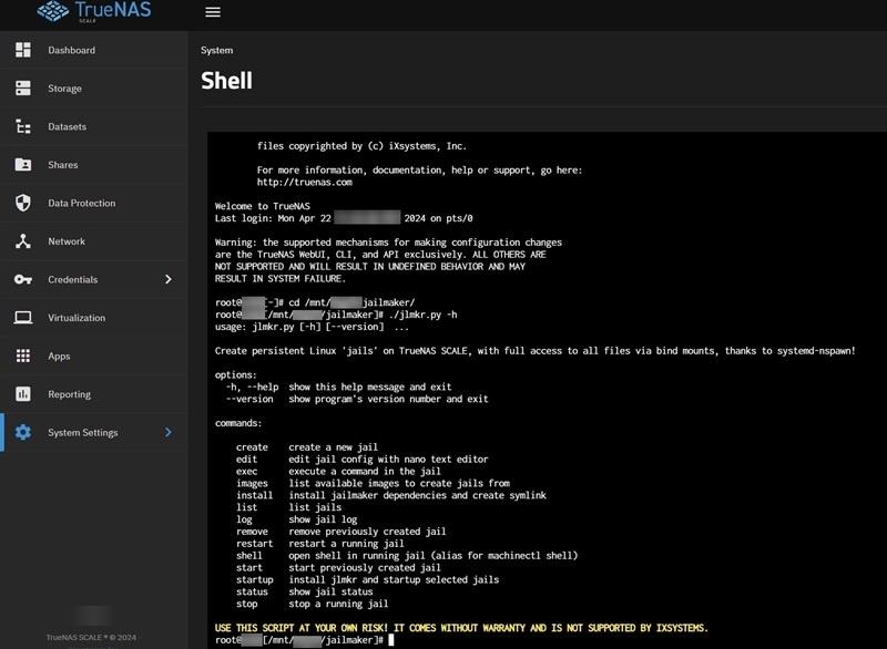

so i did a basic setup for the jailmaker but didn’t start anything. Cauz some part relied on restarting smb, and stuff so i can’t do that mid rsync ongoing :sweat_smile:
actually, i enabled smb for the jailmaker. not sure if i am supposed to do that. but i needed to access the share/dataset for the jailmaker where i plan to place my docker configs/files. Only way i know to do that is use file explorer to edit the files in notepad++
yes there is a way to edit via commandline using VI and stuff, but i try to avoid when possible cauz that’s not really my thing :sweat_smile:

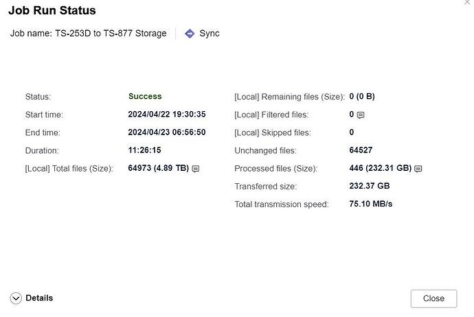

finally completed
re-running rsync to check if it really 100% copied. this is what i normally do. Run it twice, and if it’s all ok, it would quickly go to 100%
in the past in QTS HBS, sometimes you would notice it didn’t quite finish…(despite showing 100% the first run) so you only catch that if you had ran it twice… go figure :sweat_smile:

from what i read in the jailmaker instructions, i need to install docker into the jail, and also setup the os (debian?) using the jailmaker script.
That script also sets up the basic networking default it recommends.
The non default networking is a choice between DHCP bridging or macvlans. But i’m not sure how to do the DHCP bridging because it seems rather wonky based on the description by the author. Afraid i will be locked out if i mess up, so didn’t dare to do that.
So i will stick to the basic networking using the jailmaker script for now.

There is a docker template, which sets up Debian instance with docker.
Use that.
But note the current issue with the brand new latest version of docker.

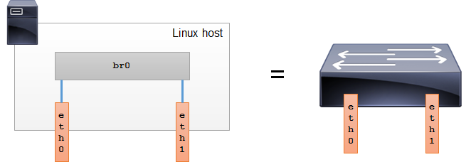

I’d setup a bridge.
Follow this guide:
Then you can put the jail on that bridge (and your TNS is also)
And any VMs you make.
I use a pfsense router for dhcp which means I can set the a MAC address to be static. Most routers/dhcp servers have this feature.
The sandboxes MAC address is hashed from its name, so is stable.
Bridging vs MacVLAN.
As I understand it, when you setup the bridge, it’s like making a virtual Ethernet switch inside your NAS, and then every VM, jail, sandbox etc connected to the bridge effectively has a virtual NIC on that virtual switch.
And the VMs can then talk to the host (ie TrueNAS)
Meanwhile, MacVLAN shares a NIC, without the switch. The VMs etc are on the LAN, but not internally connected to the host, and have to communicate via an external switch.
Ie, just use a bridge.
