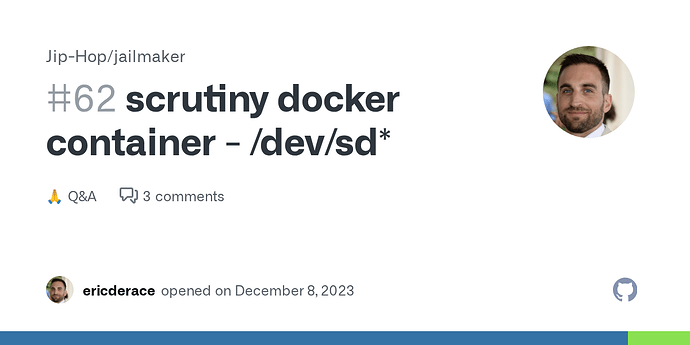

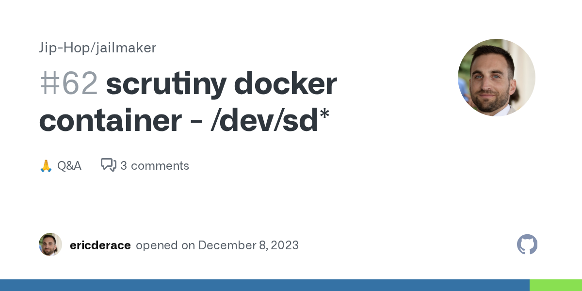

for scrutiny i further modified the docker config to add this
        --bind-ro=/dev/sda
        --bind-ro=/dev/sdb
        --bind-ro=/dev/sdc
        --bind-ro=/dev/sdd
        --bind-ro=/dev/sde
        --bind-ro=/dev/sdf
        --bind-ro=/dev/sdg
Ok good news scrutiny works now
