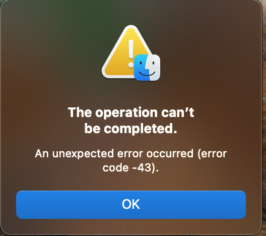

I found a file that is “bad”. It is a file copied from a home movie DVD. This is the ls -l output.
-rwxrwxr-x+ 1 rick rick 6052937732 Aug 26 2020 VTS_01.VOB.mpg
I didn’t try to delete it. I dentified the “bad” file by trying to rename it in Windows10. I get the error:
So then I tested LINUX, again renaming it:
And finally, MacOS:
Turns out error -43 can mean many things but one of them is “missing file.” Yet the file clearly shows up in all OSs.
So I ssh into the server to copy the file, which it allows, and then I attempt a delete and it deletes the file (WTF). I guess I never tried shelling in as “rick” and attempting a delete. Now I will have to wait to find another file.
I’ve typically only seen that kind of behaviour (Error -43 and the like) with files that have illegal file names that weren’t properly handled over SMB.
It’s been a while since I had such a case though and your example does not appear to have weird characters in the file name, at least based on the screenshots.
