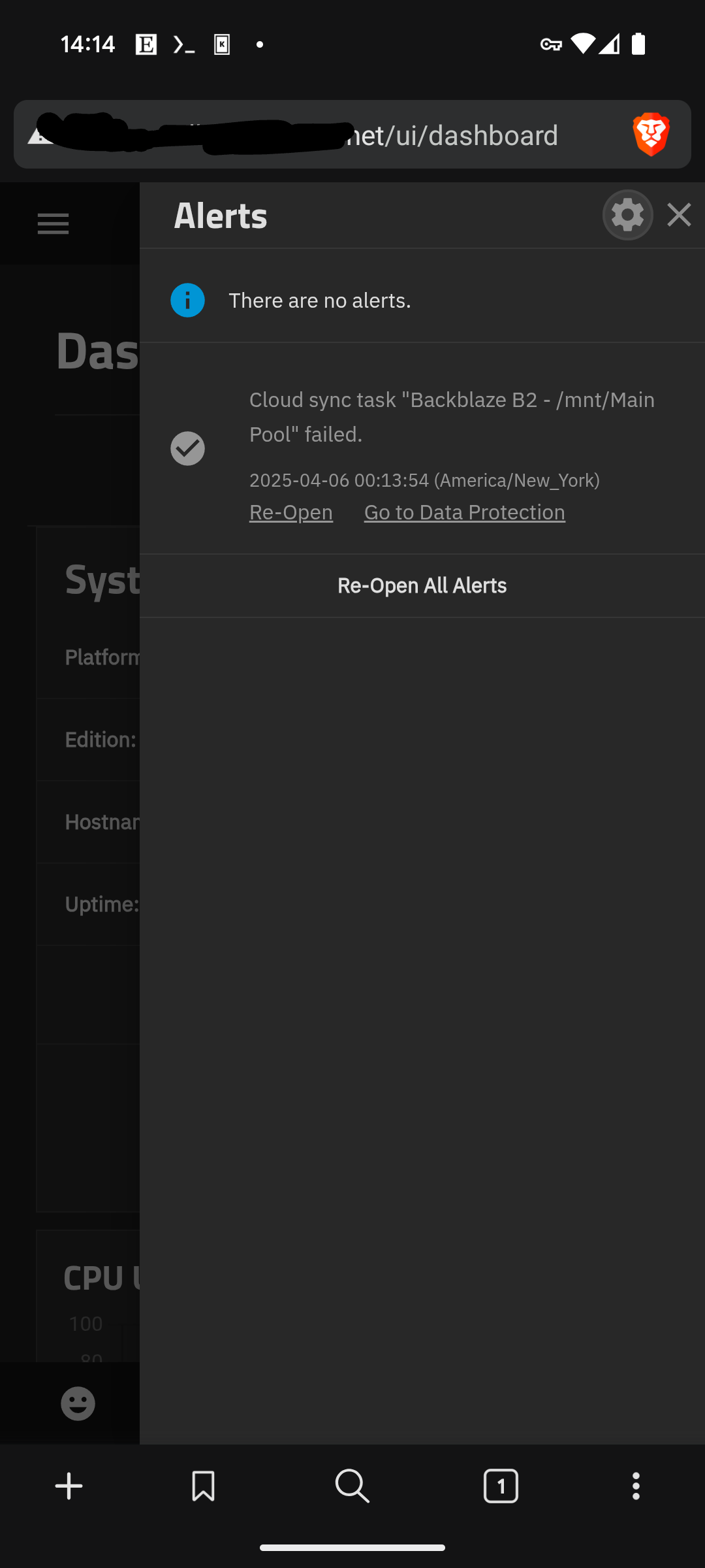

I recently re-named my ZFS pool because I didn’t realize the space in the name would break things. The old pool had a cloud sync task to Backblaze that at times would fail. Apparently one of those times was just before I re-named the pool. Now I have a dismissed alert sitting out there that will never get cleared because the task doesn’t (and can’t) exist anymore. I found a post on the old forum and followed it (since it was referenced by a few other posts and can’t link it here), however the alert persists. Is there any way to clear this unresolvable alert?

I’m on 25.04, but this error goes back to the last version as well. I can only “Re-Open” the alert. Not only that, but I don’t get any error messages. I’d upload a screenshot, but it’s not letting me. I created an account just a few days ago to ask for help.

Just tried that. No dice. But I’ve passed the new user threshold so here’s a screenshot (mobile).
Coming back to this a year later, and I finally dismissed it. Here’s what I did:
  1. # sqlite3 /data/freenas-v1.db
  2. sqlite> select * from system_alerts;
  3. From the alert, get the “id” of the task that failed.
  4. sqlite> select * from tasks_cloudsync;
  5. Find a task that is known to be successful, and note its id in column 1 and description in column 2. You will use the description to update the ID in the next steps and the original ID at the end to restore what you previously had.
  6. sqlite> update tasks_cloudsync set id = <ID OF FAILED TASK> where description = "<DESCRIPTION OF WORKING TASK>";
  7. Refresh the UI for Cloud Sync, and run the working task
  8. sqlite> update tasks_cloudsync set id = <ORIGINAL WORKING TASK ID> where description = "<DESCRIPTION OF WOKRING TASK>"
I was able to run these commands, and it cleared out the failed alert specifically for Cloud Sync. Theoretically, it would work on other task failures where the task ID is no longer valid. This survives reboots and runningsystemctl restart middlewared.
