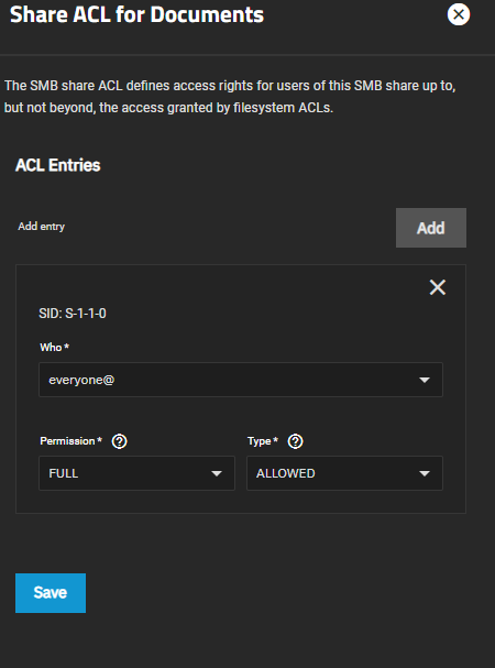

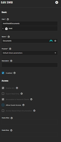

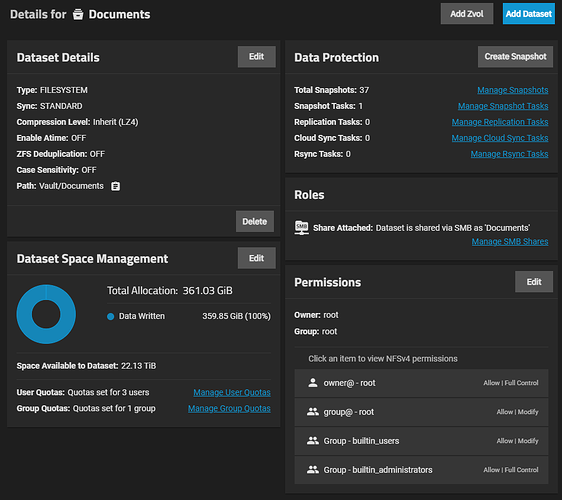

Can we a see a screenshot of your full permissions by clicking ‘Edit’.
Also did you use the standard defaults when creating the SMB share and did you not modify the share ACL?
Thanks
Dataset ACL
Share
Share ACL
I don’t think it can be the share as it that would affect both i.e. if I have permission to edit one through the share door then I have permission to edit both through that door
