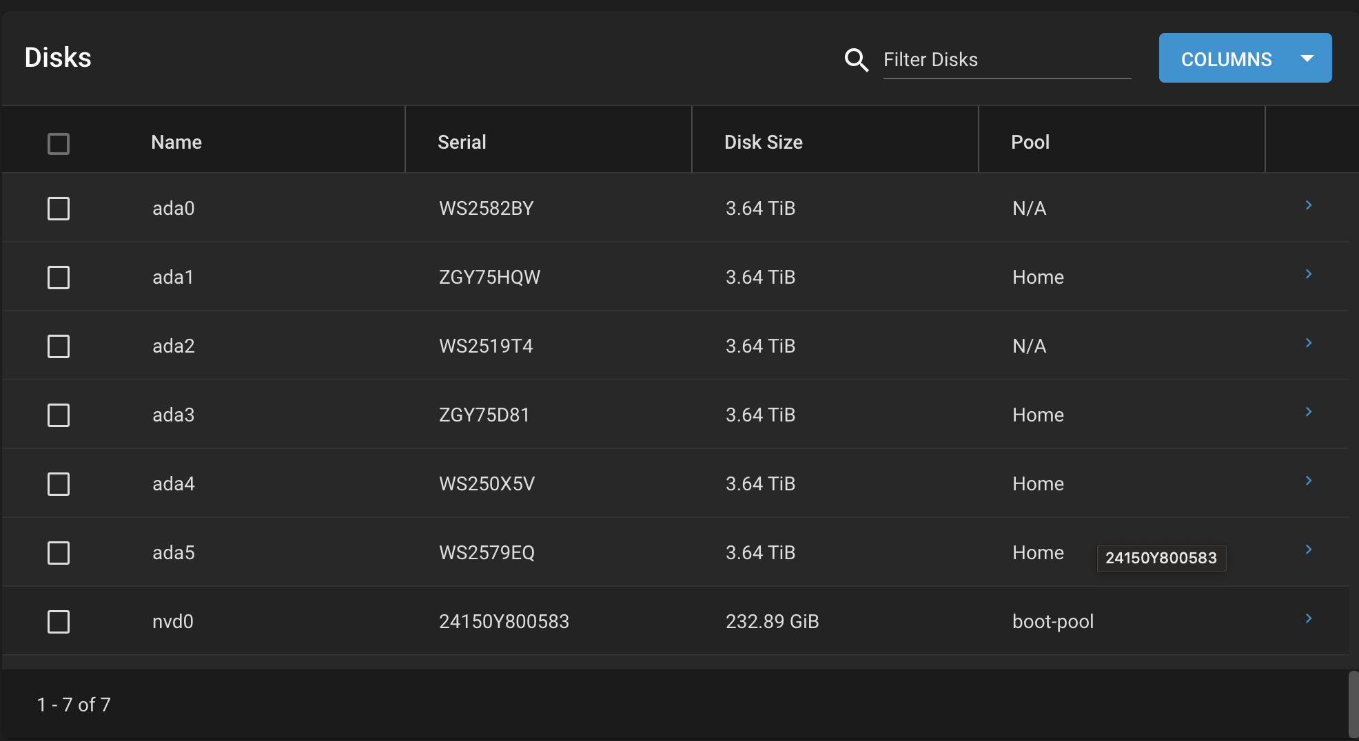

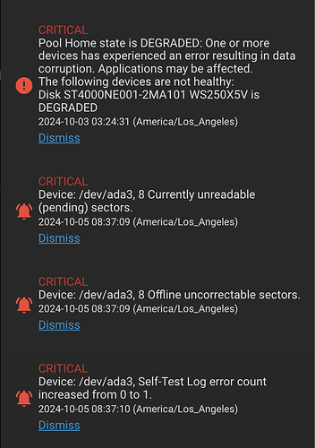

Here’s some new updates. I tried running smart tests on each of the disks. These are the errors I came to this morning in TrueNas. Any help from anyone would be appreciated

smartctl -a /dev/ada3 will show that the drive is growing defects. Replacement time.
