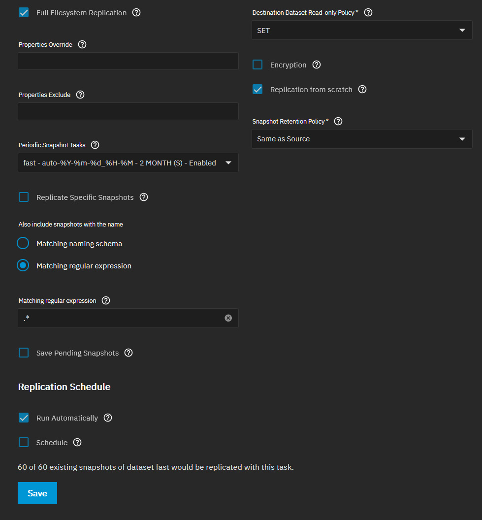

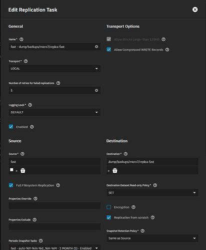

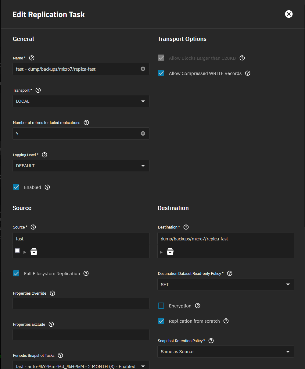

This is the job setup
what can I do? thanks
I think my issue is related to me wanting to replicate all snapshots so it doesn’t work if i use “." as a regular expression to match all of them.
If i go back to the standard settings “Marching naming schema” the replication works.
What is the recommended way to be sure to replicate all snapshots of a dataset? I tought I got this ".
” from the documentation but I can’t find any reference to it.
thanks
