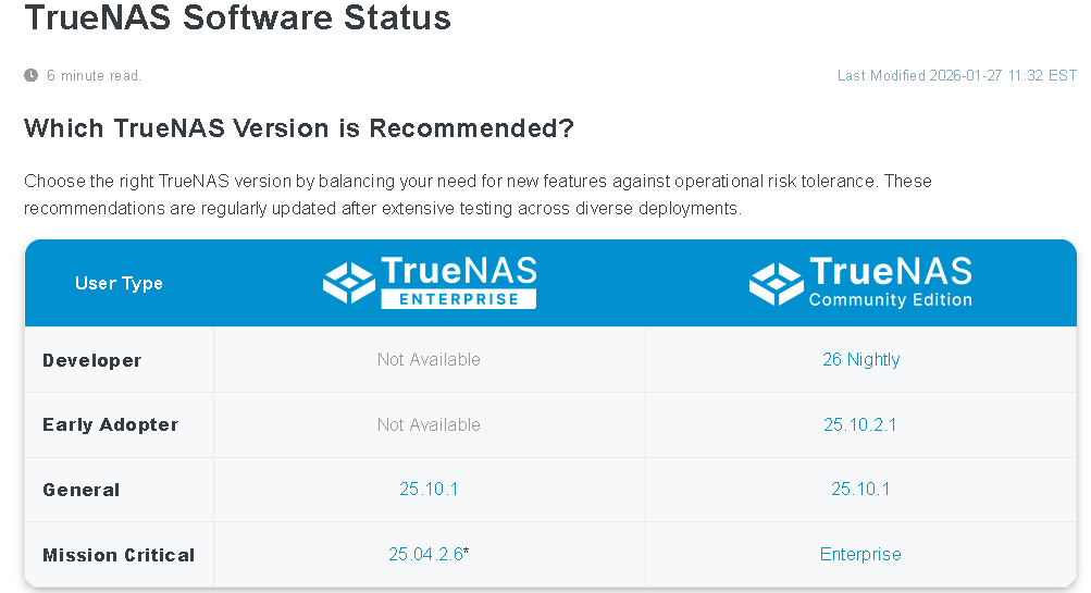

Is there a reason for sticking with 24.10 version of Scale? I would expect 25.04.2.6 or 25.10.1 just for the updates, etc. General or Mission Critical.

my version is 24.10, and I do not see any compelling reason to upgrade my prod NAS yet at the moment.
