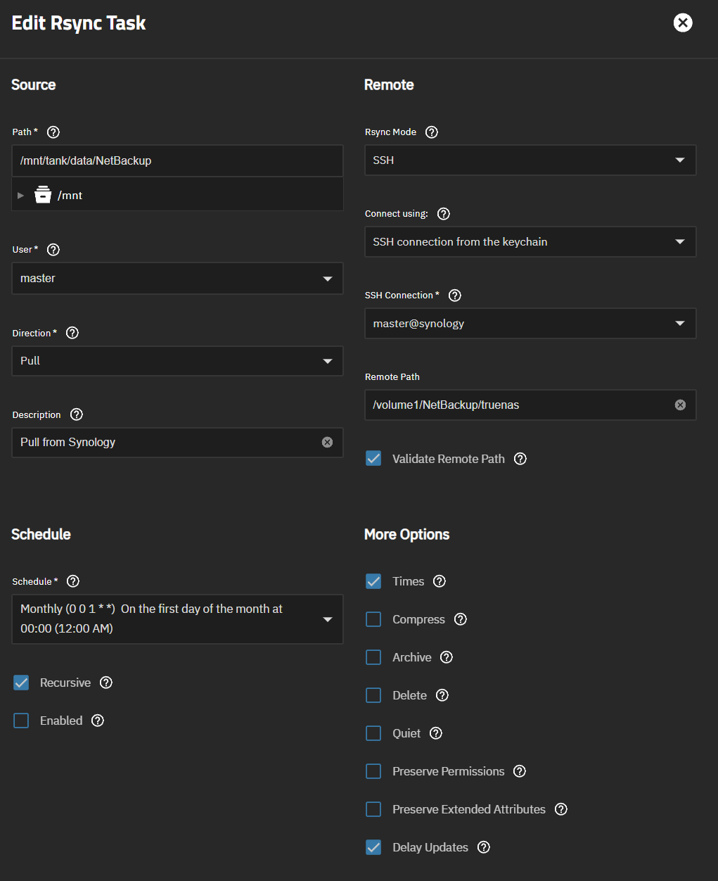

all my RSYNC Tasks seem to fail as soon as I set the checkmark to preserve the times. An example for an RSYNC Task is:

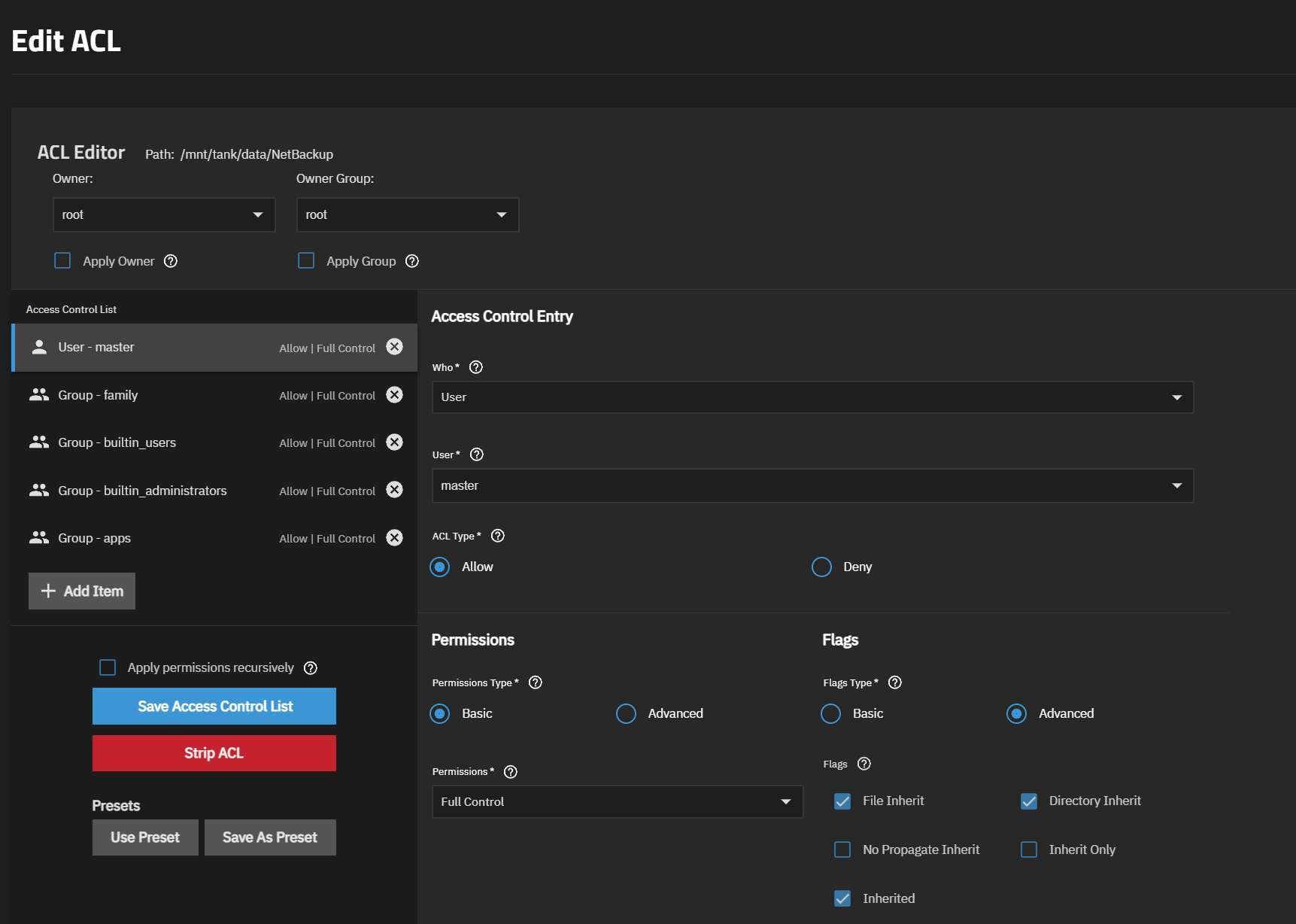

My ACLs for the NetBackup Dataset that I am pulling to on the truenas look like this:
Parent dataset permissions are basically the same.
What am I missing?
My current version: TrueNAS SCALE Fangtooth 25.04.0
Any help would be greatly appreciated.
You look to be using NFSv4-style ACLs (instead of POSIX ACLs) on that dataset.
I believe rsync cannot interpret anything beyond the “owner” for NFSv4 ACLs, which in this case is root. Meanwhile the user running this process is the username master.
You could try setting the owner of the dataset’s root path ACL to master, and possibly not just apply this, but apply it recursively. The “Apply Owner” box needs to be checked when you click Save. Alternatively, you could try to run the task as root instead of master.
Another option is to start all over with POSIX ACLs, instead of NFSv4-style ACLs, which will strip the current ones and replace them with the simpler POSIX ones.
I’m not sure how comfortable you feel with starting all over with your dataset’s ACLs, which will affect all files and folders inside.
I would be ok starting over with POSIX ACLs, I was not even aware of the specific differences. My current permission structure isn’t overly complicated.
How do I start over however?
I did also just out of curiosity try it by changing the “Owner” to master and the “Group” to builtin_users as well and just like you said with changing the owner the rsync process ran and returned “SUCCESS”. So looks to me that RSYNC can really only read the “Owner”.
